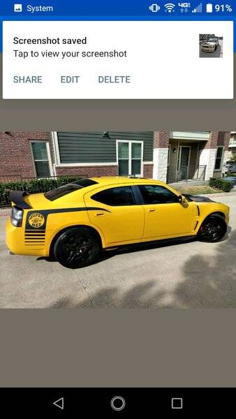

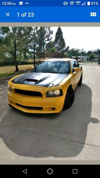

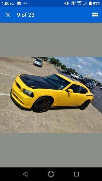

Just for the sake of pictures here's the bee
