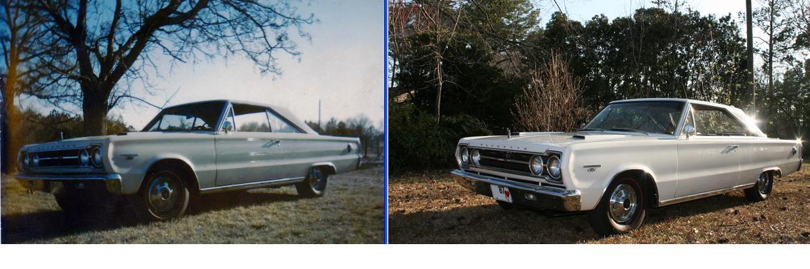

Here are a couple of pictures. The one on the left was taken sometime around 1967. The other one is from today. I was trying to get the shadows and angle like the old Polaroid. Just 44 years latter!

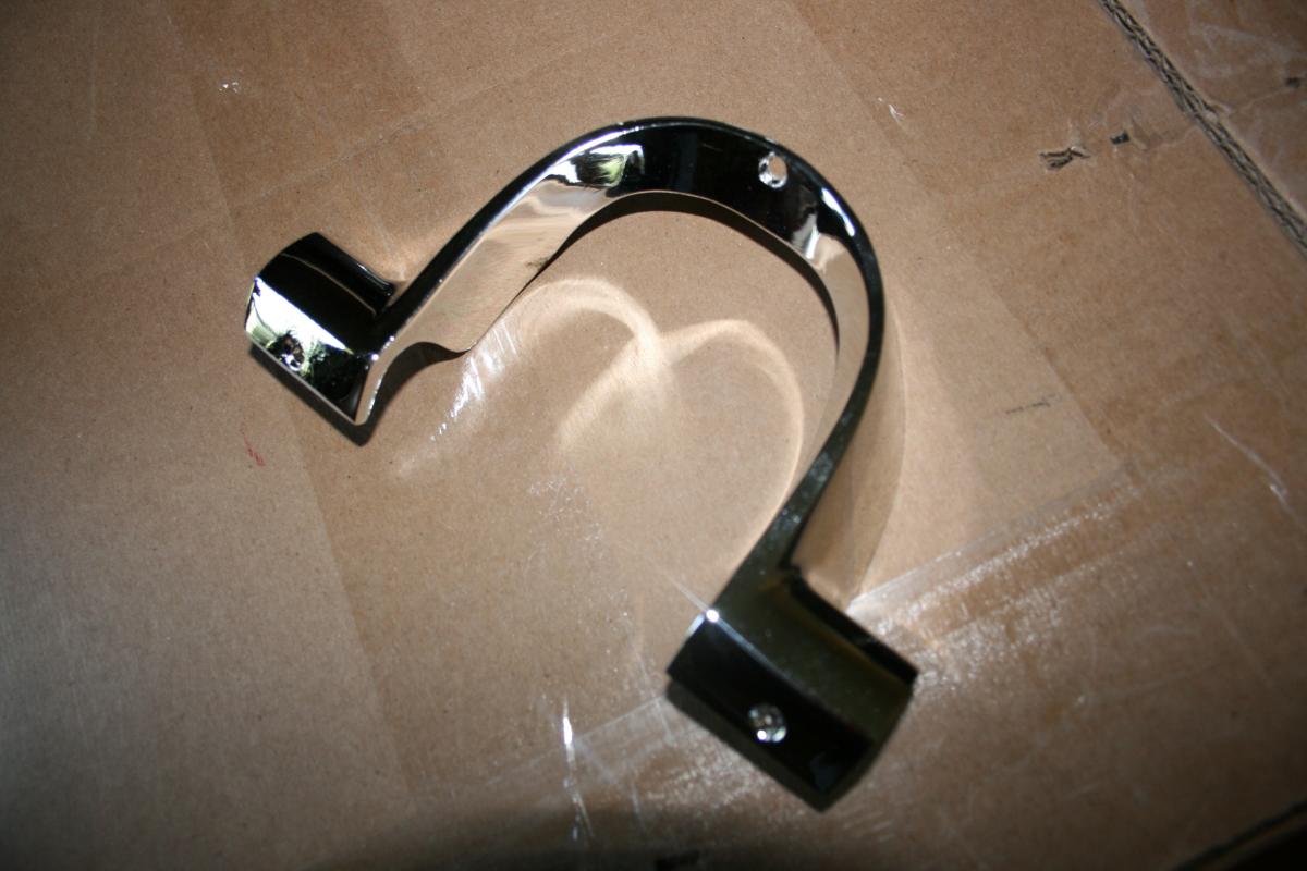

The instruments should come back this week so I need to finish up with the dash and radio installation. I still want to rechrome the bumpers, replace the arm rest bases, window cranks and inside door handles. I also have to change out the rear arm rests, the original ones have ash trays in them.

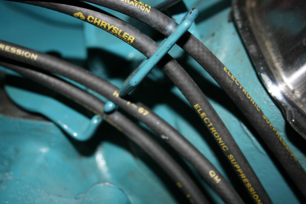

Down the road I want to put date coded plug wires, hoses and replace the fan belt with the Mopar item and get the correct Mopar battery. I am going to work on detailing the underside also.

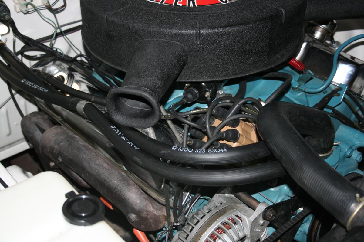

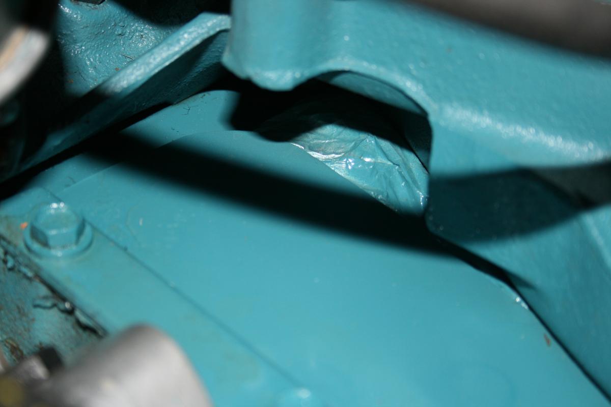

I installed the date coded plug wires, tan distributor cap and heater hoses with pentastar and part number. I also put in the tappet scliencer pad that goes under the intake manifold and took the paint off the number pad on the front of the block.
There is a good shot of the engine in the 1967 Belvedere brochure and the number pad is unpainted.

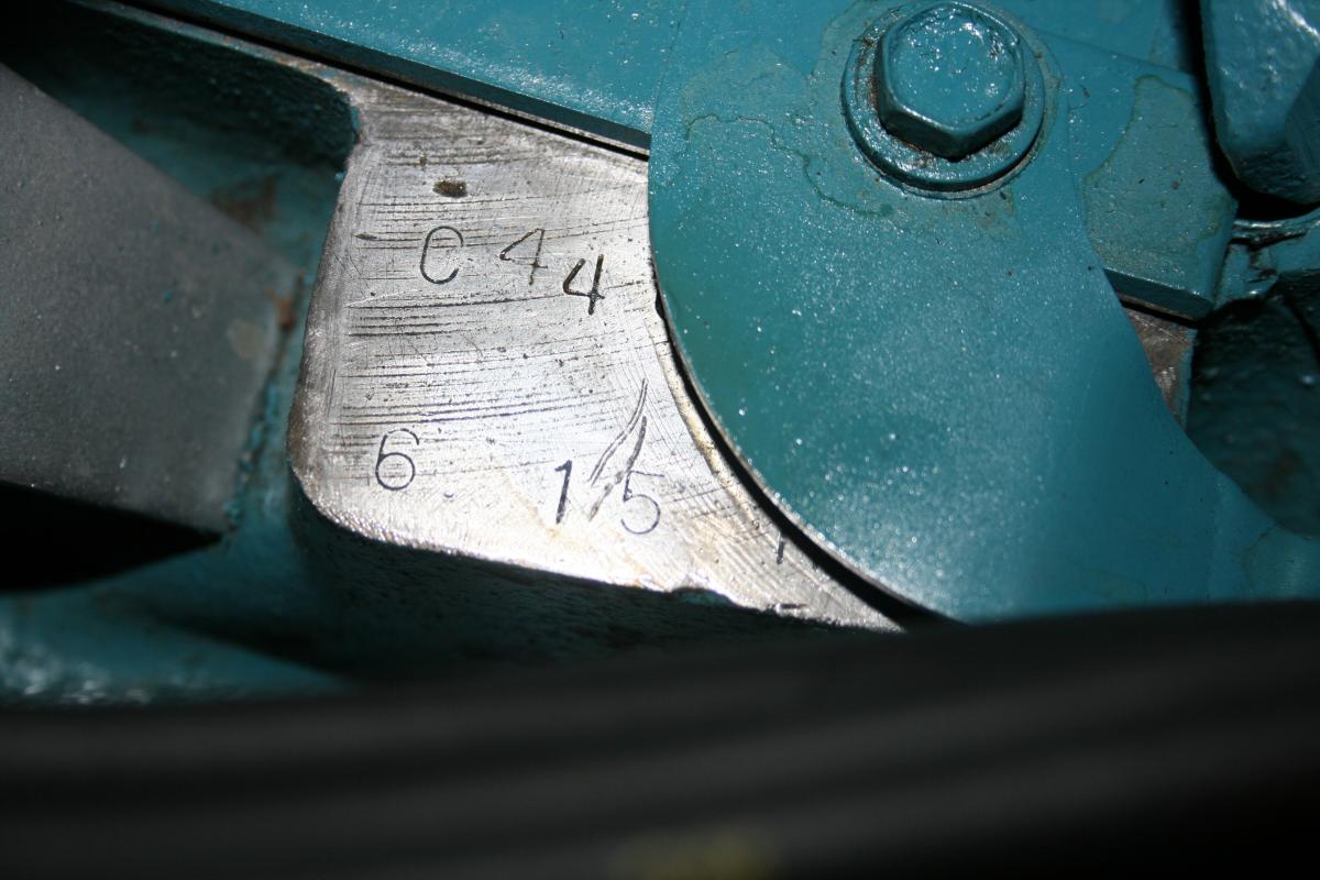

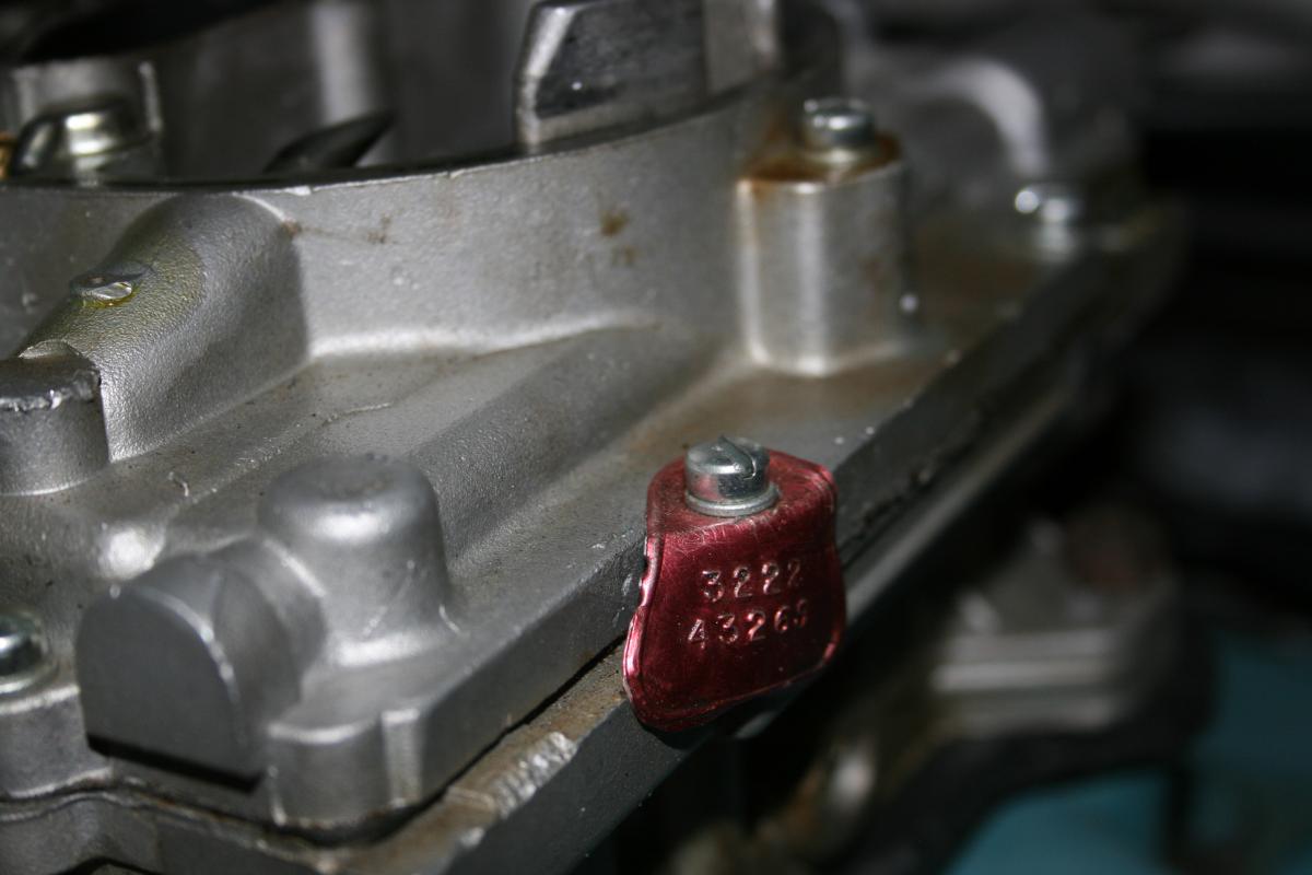

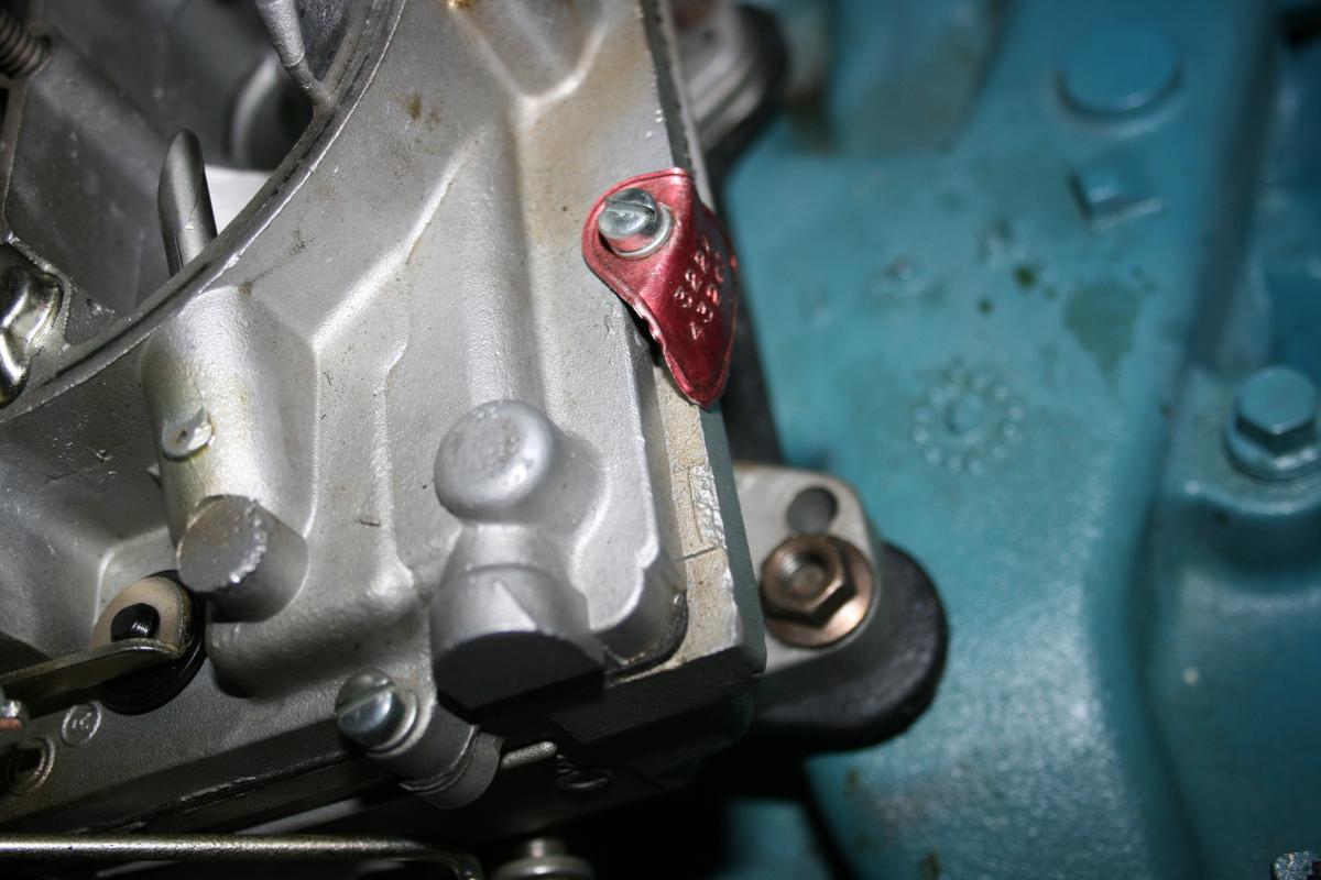

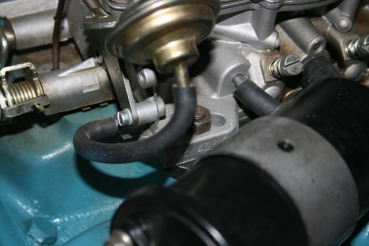

Close ups. Engine build date 6-15. Carb number 4326S

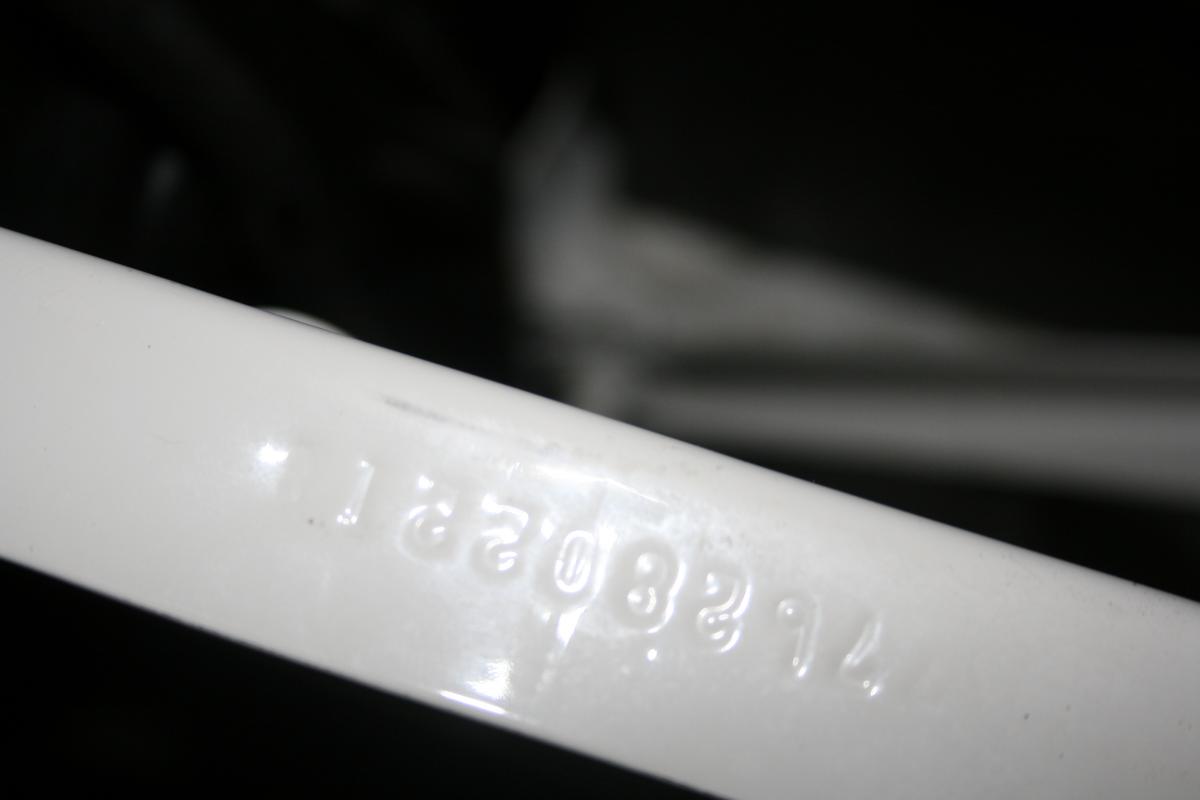

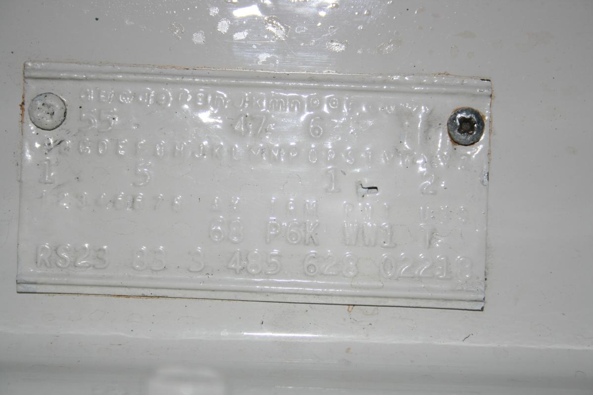

Fender tag and radiator support stampings. Build date 6 28. Sequence number 02218. Radiator support stamping photo is upside down. Shows
762802218 7 = year 6=month 28=day 02218 = sequence number

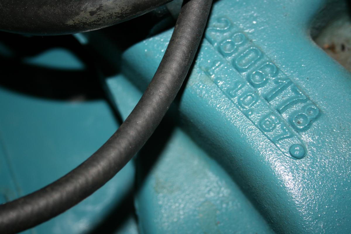

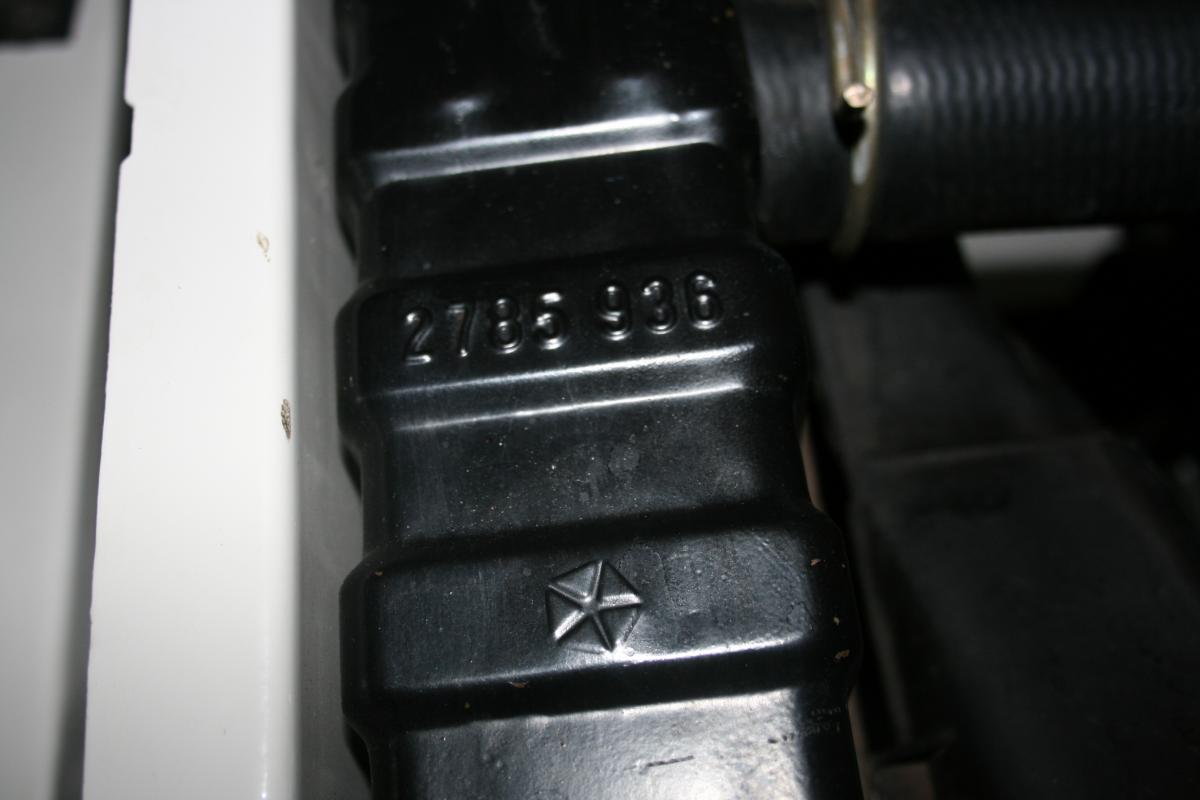

Carb number 4326S. Intake manifold casting date. 1-10-67. 936 radiator.

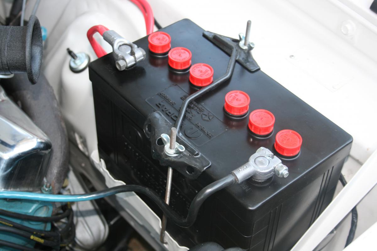

Got the Mopar restration battery from Summit. Lot less than Year One had them priced.

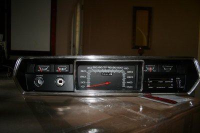

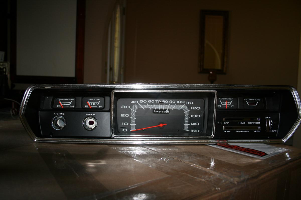

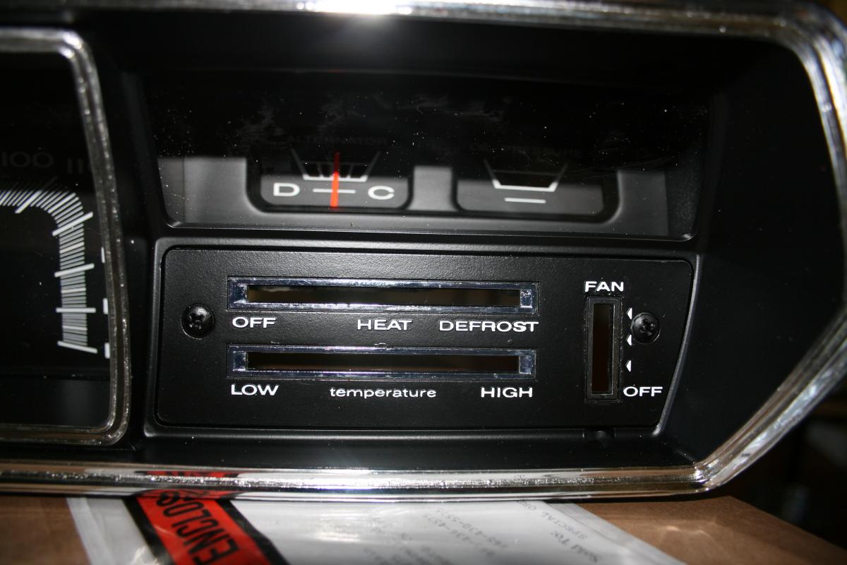

Finially got the instruments and yoke back, still waiting on the glove box door.
was the chrome piece that went around the end of the steering column an option?
Auto Instruments in VA. They took ten weeks and I still am waiting on my glove box door. And it wasn't cheap!
You lucked out. G - Car had my stuff for just bout 6 months. They weren't cheap either. LOL They did do a great job though.

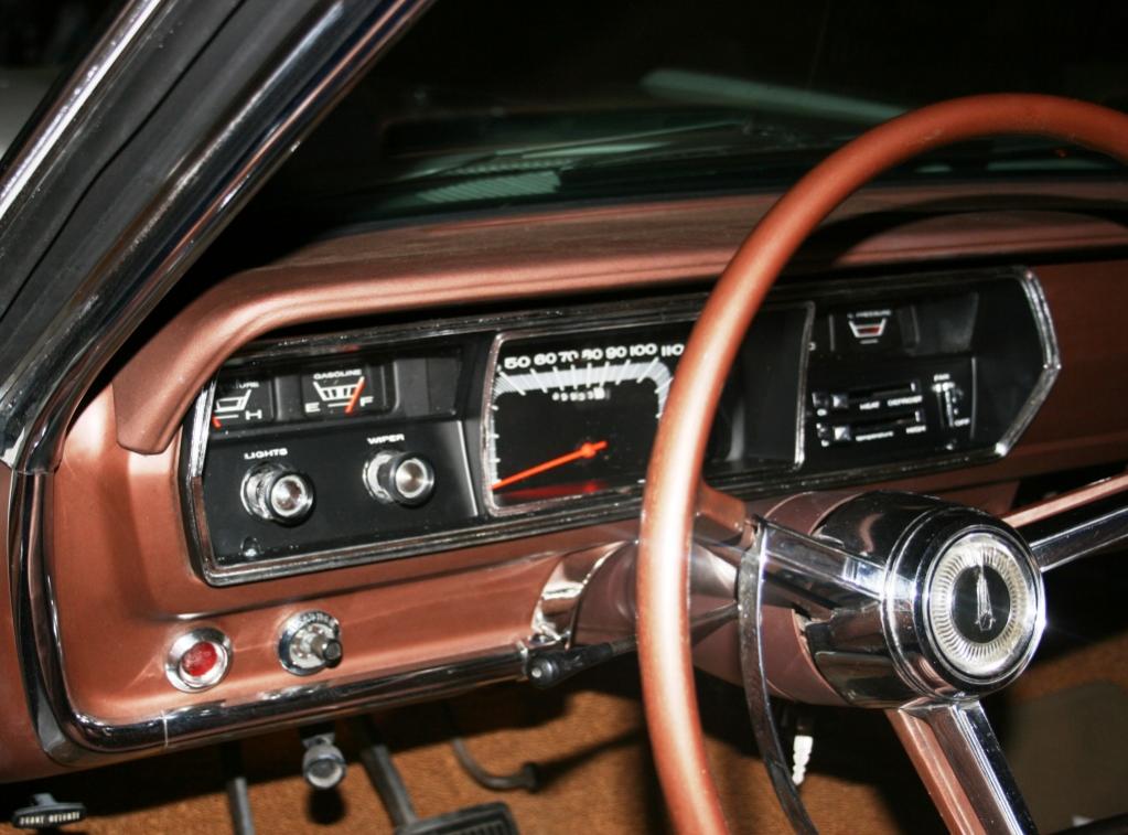

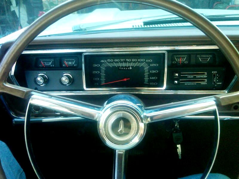

Got the instrument cluster in. They kept the actual mileage, 99913. I will get to see it "turn over".
when my coronet tripped a 100,000 the speedo acted and sounded crazy and my speedocable broke true story.
They rebuilt mine. it was working fine but they said that usually they are worn out at 100000.
