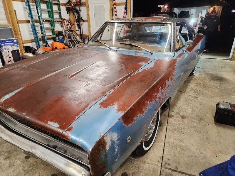

Had a minor setback with the Admins thinking I was not a real person, so I lost my previous post about this car and project. My Uncle Larry bought the car in 1968 and his daughter helped him work on it when it needed it. Now, my daughter and I are restoring it as it has been parked in a barn since 2007. The previous post was full of pictures, as well as very helpful suggestions from this community. I will not try to recreate the previous post, but all the work done up to this point has been recorded here I will continue to post pictures and update this thread as progress is made.
