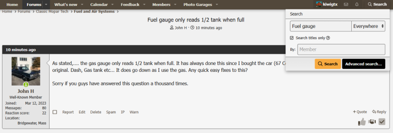

Yeah, it has. You are the second person in the past few days with a similar problem.
Some sticklers on the forum might "advise" you to do a search before posting a question since many of the things that new owners encounter has been dealt with many years ago by several other people.
This is one of those issues but hey....I'll chime in anyway because I have to make up for some smart *** stuff I've done over the years.
