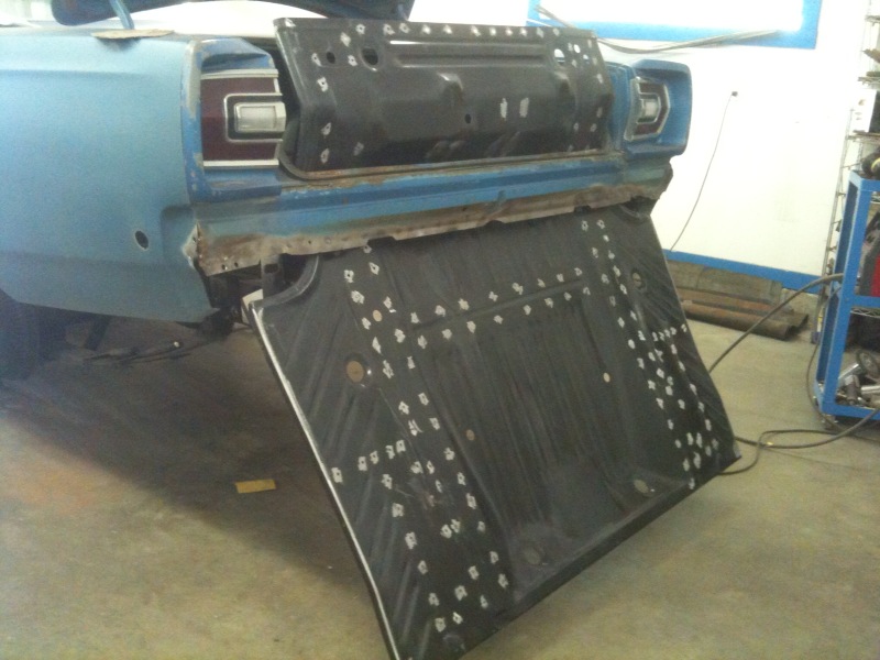

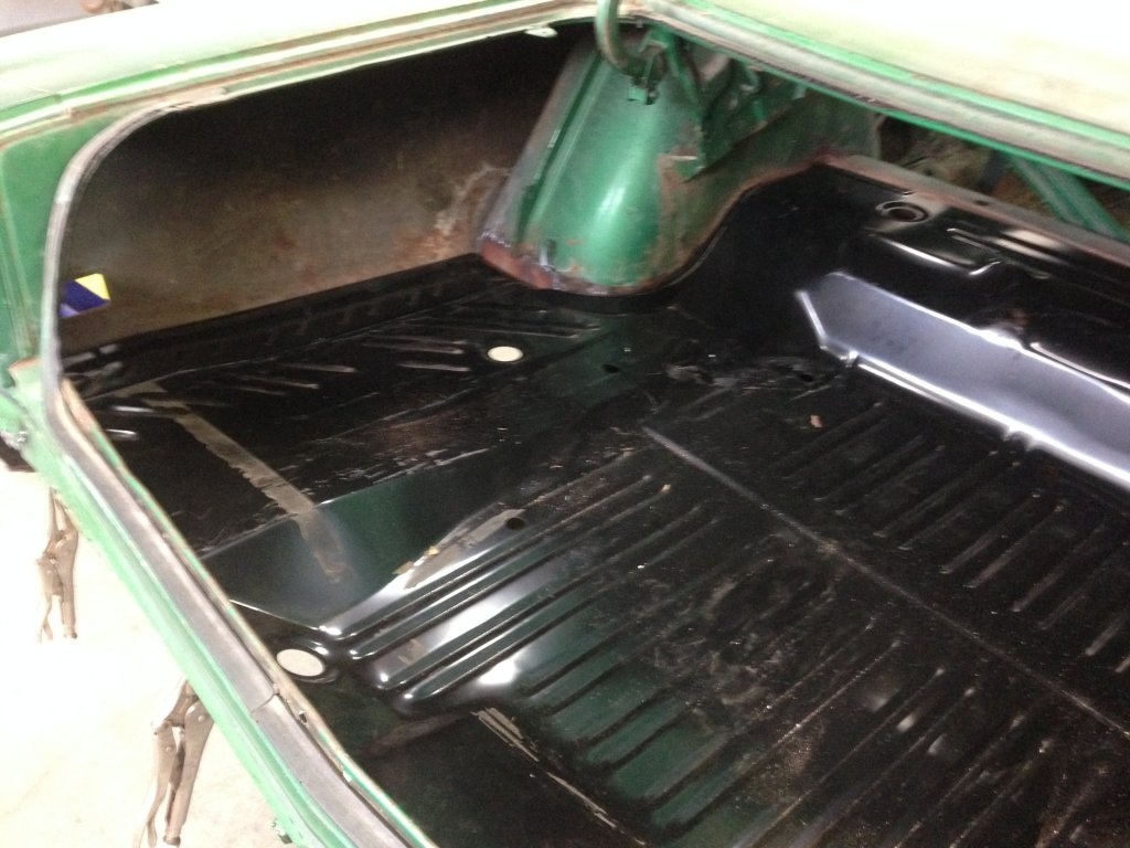

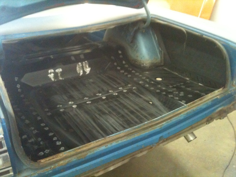

Working on a 70 GTX & it needs the trunk floor replaced. The owner got a 1 piece trunk floor. Im not sure how to go about installing it. I never installed a 1 piece just the ones that come in 2 haves. I am going to have both quarters off. Any ideas ?

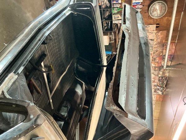

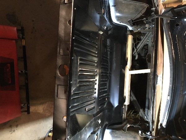

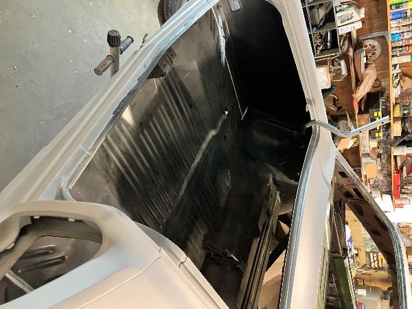

Then once one quarter off slide pan in and drop offs attach quarter and repeat for the other side I say

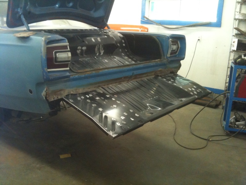

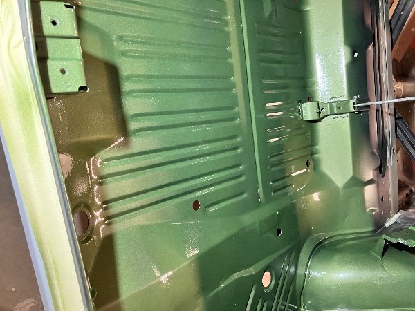

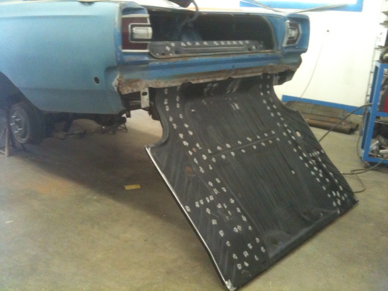

I put a '72 Charger floor into my '74 Charger with fixed (louvered) quarter windows. It wasn't fun, but I did it. I kind bent it into a "U" front to back centerline and got it in and turned then put into place.
