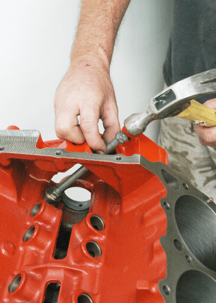

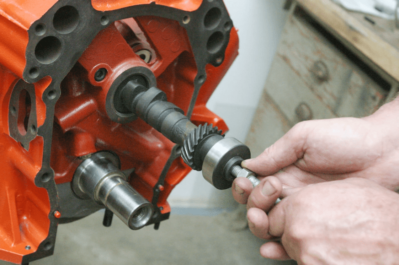

Yes I remember seeing that. That was a long time ago. Maybe I missed something or forgot. At almost 69 I do get some CRS. I believe the chamfer was minimal and they most likely tossed the idea. There is a lot of oil getting squeezed out in the front. Front Main and Cam bearings. Then look at the big intake valley diagonal slot. That slot allows oil from the valley to pass through along with the oil pump drive gear slinging oil. Mopar was stupid with the manuals. They failed to edit them many times over and carried the same text from year to year. It was a joke in the tech schools. Look at these two photosPnora, ...I appreciate your dealership service dept experience & wished I had similar,.....Did you seem to miss or not notice the 1970 Plymouth Service Manual (group index 9--82) huge, Bold, black Warning Notation ? .... It's Much Bigger, blacker, Bolder Notation than even the Critical # 3 Main Thrust/Flanged Bearing (big deal important !! ). Non--interchangeable issue so I interpreted That # 1 Main Upper of Some Chrysler significance affecting issue to attend to......I remember back in '72 (my 1st Mopar engine teardown) asking myself "how does this well engineered, impressive Double Roller timing chain assembly get Adequately Directly lubricated",. but youthfully & ignorantly (no service manual),. assumed "it somehow just does" & tended to more Impressive sights as the huge ports, valves & piston valve relief Hemi things.....I was Super youthfuly Excited wrenching on my 1st New 426 Hemi !!!
