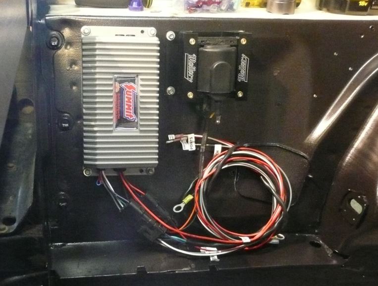

I think the MSD is a smaller box, here is what mine looks like.
Good luck!

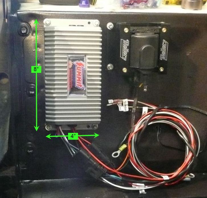

Hey can you give me measurements? I mount mine in the same basic spot a little lower.

Good deal, let us know how it goes. Here are the measurements.

Got the summit box installed last night and she fired back up to life with a vengeance lol. Got most of the wiring cleaned up. The box lined up with the MSD mounts perfectly.
