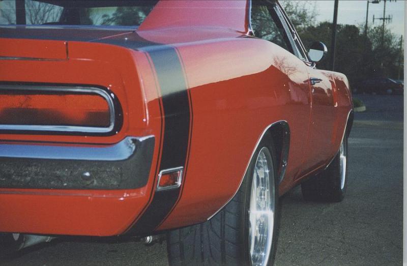

I don't know if ALL 68-70 B body cars used the same wheelhouse, but on the Chargers, the tub isn't flush with the quarter panels. It sits INboard a few inches, preventing you from running tires flush to the body....UNLESS the car is raised up from stock. I like to turn corners, so my car is lowered. I have 18x10 rims that measure 11 1/2" wide on the outside edge. I'm thinking of cutting and modifying the tubs to allow me to push the rims and tires out to within 3/4" of the edge. I think it looks better and may help the handling by providing more stability.
The picture above needs explaining. Its NOT as simple as it looks!
In 2000 I bought an 8 3/4" axle for this car to replace the original 8 1/4". Yes, the car was originally a 318 powered "500" model.
Anyhow, I pulled an 8 3/4" axle from a 67 Belvedere wagon. I thought that all 62-70 housings were the same width. I later found out that the 66-67 units were a little narrower than the 68-70. The axle in the picture is the 67 unit and the wheels have 4 3/4" of backspacing. Later I added XHD leaf springs and lowered the car 1 1/2" and had interference with the outer wheel tubs. I had another axle cut down to be 1 1/2" NARROWER than a 66-67 housing. Once I modify the wheel tubs, I'm planning on installing a 68-70 housing to push the wheels out to the edge.
