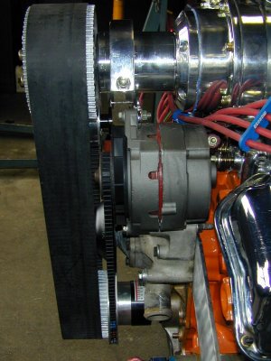

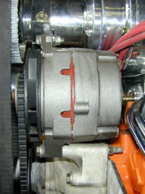

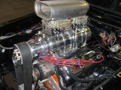

I finished this up on my 66 and it works great.
I mounted the alternator on the power steering ears of the water pump.Mine was done YEARS before a mopar one wire was available.
