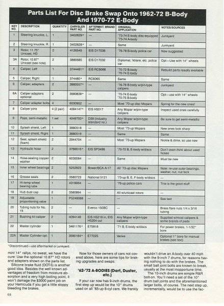

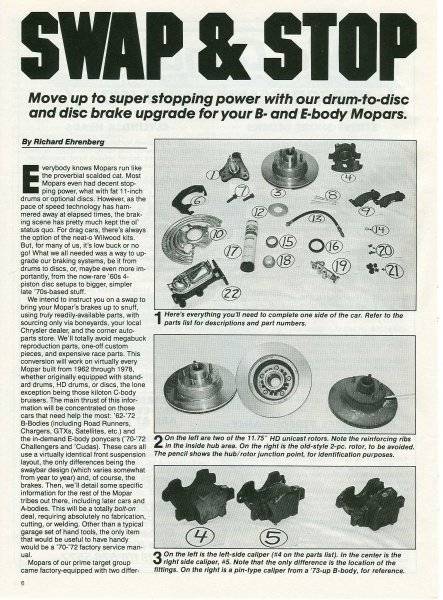

Dr Diff makes the caliper adapters for 11.75" Rotors. Don't known if they work on drum brake spindles. you'll need to do some research. I did this swap in 20002 when parts weren't as costiy, about $650.
