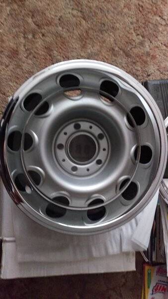

I have been looking for 14 inch trim ring for a set of 70 or 71 rally wheels. All the Mopar ones I have found seem to be too deep. My beat up rings measure 2 1/4 inches deep, (not at an angle). Here is a set that measures 2 1/4 deep suposedly for Gm products but damn they look like Mopar to me!!! Has anyone used these on the narrow Mopar rally wheels?...Thanks. Ed

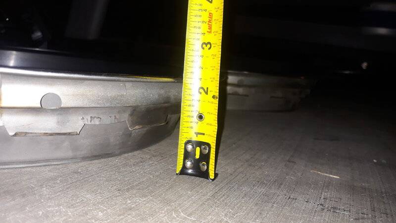

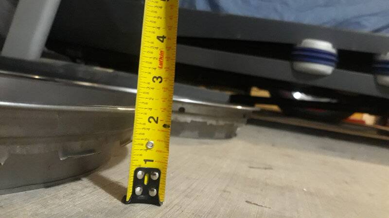

Oem 14" factory trim ring . I just measured.
2.25" to the top of the face of the ring

A 15" ring will fit any 15" rim.
Its the depth that makes it C body or truck.
No moper muscle car era vehicle ever used a trim ring that shallow/narrow.
EXCEPT the 1969 recall wheels.
And the trim ring for them is pretty unique
That ring looks exactly like the ones I have sold in the past. It is a chrome ring , the valve stem hole and the attachment are different than factory , but it does have the step in the outer edge , similar to a Mopar ring. Good price , cheaper than what I sold them for , I think I still have a couple of good ones and four that have a couple of slight scratches in them.
Frank

Thats interesting. My rings measure just like yours, 2 1/4 deep. After cleaning off the paint on the wheel I found the part number 2944388, and in my research I found that these are 14 X 5.5 rally wheels, 4 inch bolt pattern, and fit 70-71 a body cars????
