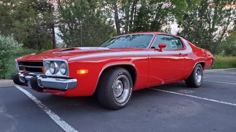

Right now I’m running factory 15” Rallyes with new 245/60R15 Cooper tires on all four corners. I saw the 10” wheels and tires for sale locally and thought they would really fill out the rear.
