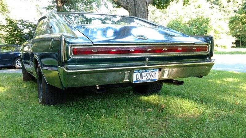

I have a 66 Charger and like the stock 14" spinner hubcaps. Does anyone make a 15" wheel that a 14" hubcaps will fit to? Tire sizes in 14" are very limited.

The widest commonly available is a 245-60 which is not nearly large enough for a 66 Charger (at least for my liking).

Exactly, the rear tire well of the 66 Charger is way over sized for a 14" tire. Got to fill it up.

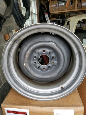

http://themopardude.com/New_Custom_2.html
They have a wheel that is 15" that you can run a 14" cap.
My impression is that that is only for dog dish/poverty caps, as they use a 14" OE wheel centre. Full size hubcaps like our spinners for 14" wheels have nothing to grip onto in a 15" rim.

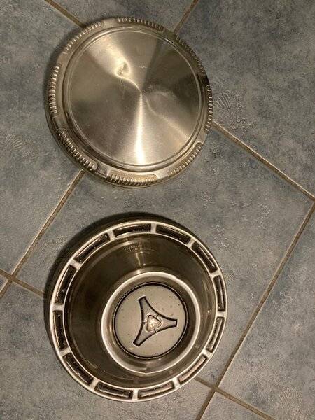

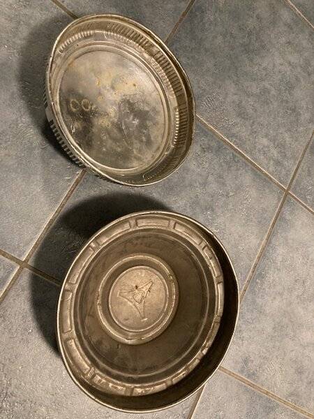

Gents, I will pickup this posting. At moment, I drive the 15" MOPAR OEM Steel wheels with the 9" dog dish caps.
But I wanted to drive (convert) my 15" in this way, that the older 10" dog dish caps work on it.
Can anybody help me out?
on this pic the 9" dog dish caps mounted.
I guess you could glue the 9" inside the 10 inch cap.

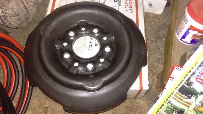

Or you could spend the money and get new wheels built , with the 10 inch wheel centers in the width you want for your car.
Frank PS. I only have the wheel centers
Not the completed wheel.

Do you have a supplier with a part number for me?
I also looked in the internet for avaialble wheels, but nothing found. :-(
You can buy the wheel centers from me and I could send then to a builder of your choice. Or you can contact The Wheelsmith , he can build the wheels and did have some of my wheel centers in stock.
PM me for more info.
