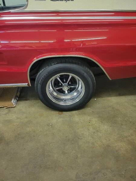

I found that 15x8 with 245/60/15s would catch on the wheel lip molding. I have 215/65/15s on the front.
15 x 10 295 50 on a (vinyl top!) 67 charger.
I don't remember backspace specs, but had to space them out about 1/4 inch.
See tire grinding on inner..
