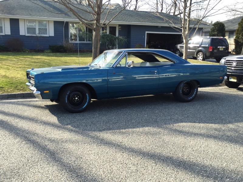

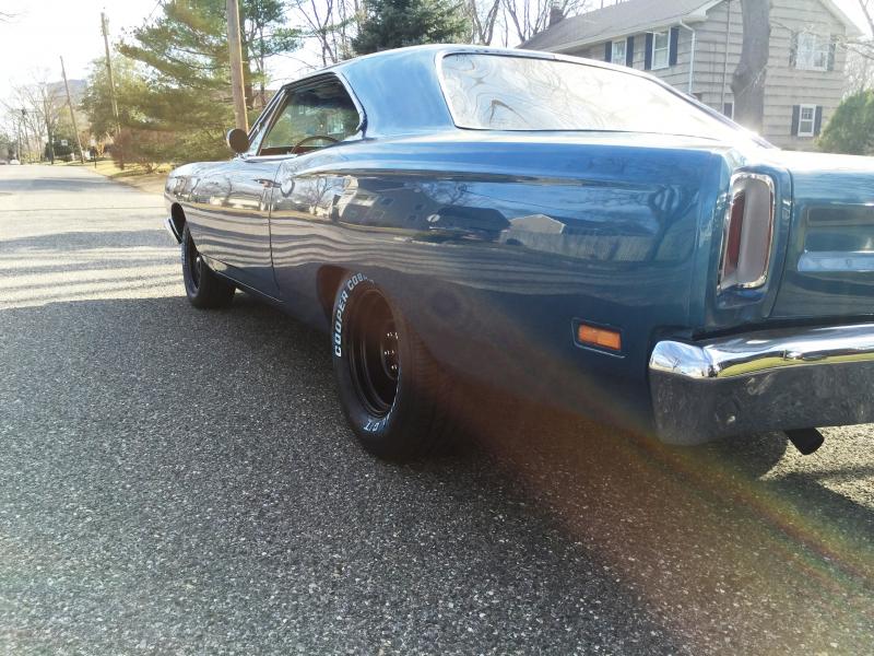

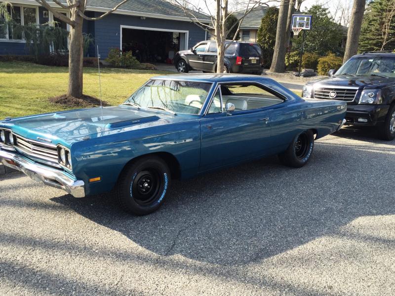

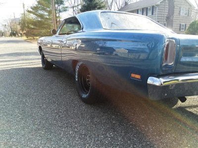

I just put that exact tire combination on mine yesterday...except I went with black steel wheels (15x6.5 and 15x8). no rubbing, no interference and I have stock suspension and stock drum brakes all the way around. judge for yourself As far as lug nuts, I ordered new chrome ones. if you do end up ordering new lug nuts...make sure that the studs you have on driver side are still left hand thread or not before getting new ones...mine were still the original studs. rr69.1x.jpgrr69.2x.jpgrr69.4x.jpg

thanks silversedan.
Those wheels on your bird look cool. Just what i want really.
Thanks djais1801
Yes my drivers side lug nuts are left hand thread as they are original stock hubs.

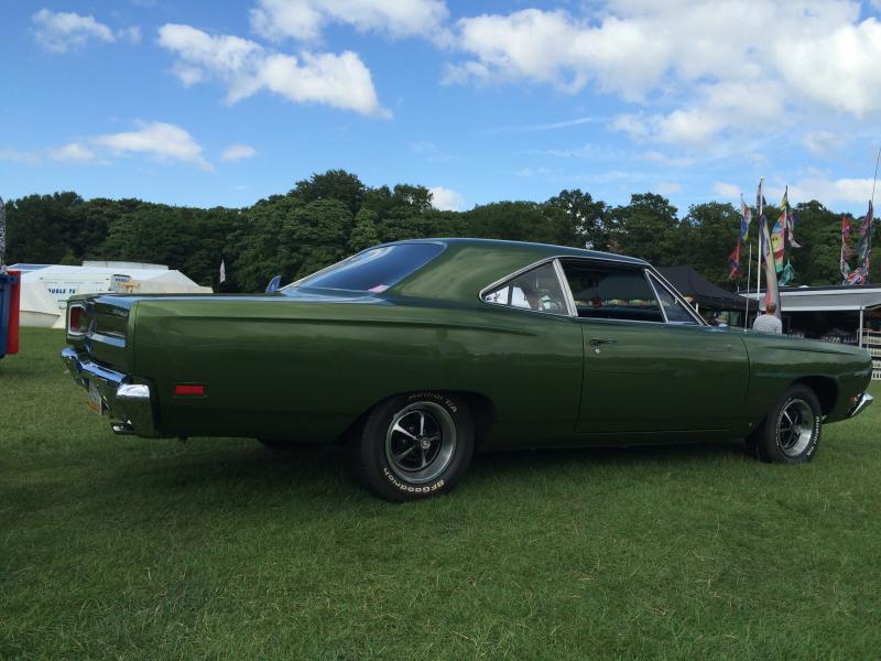

Those wheels sure fill the arches out well :)

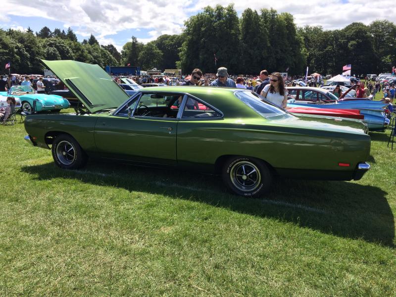

This is mine at a show in the UK last summer.

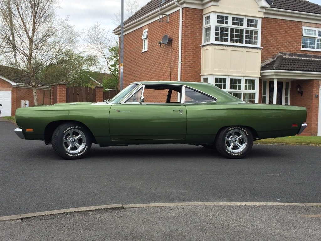

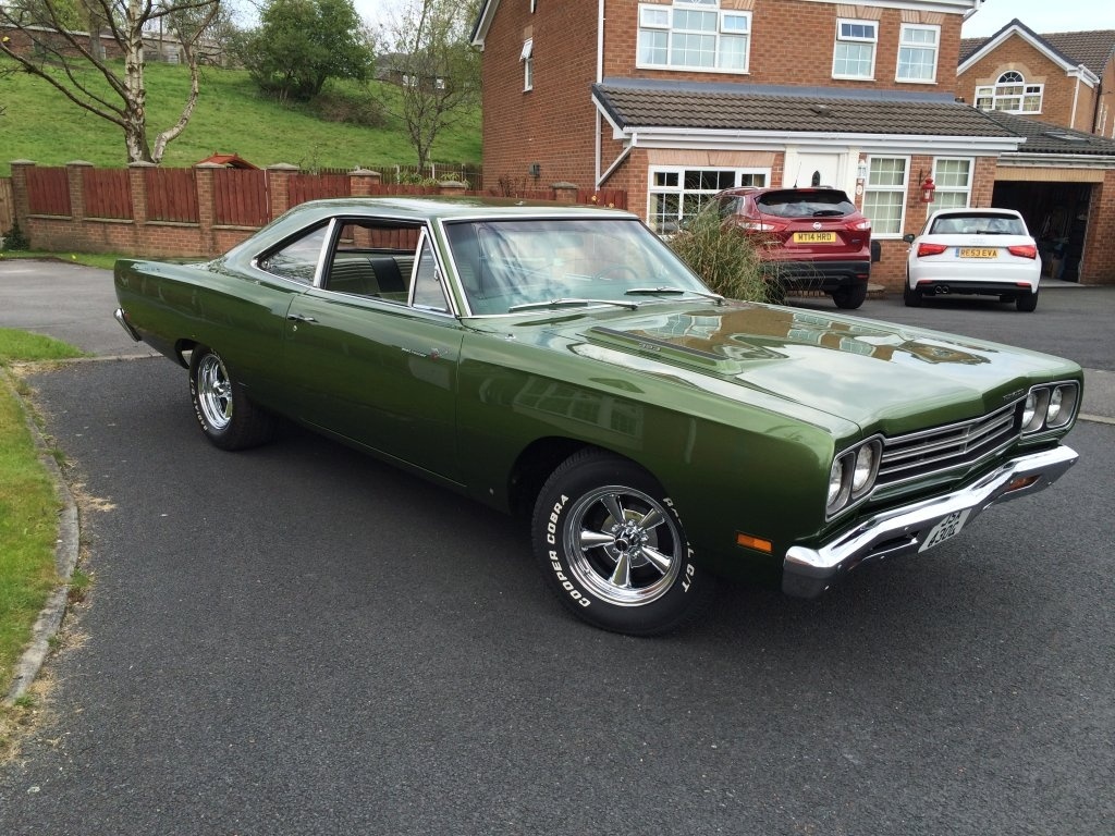

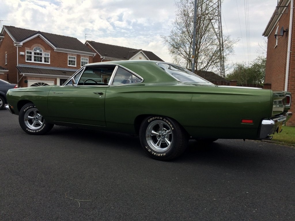

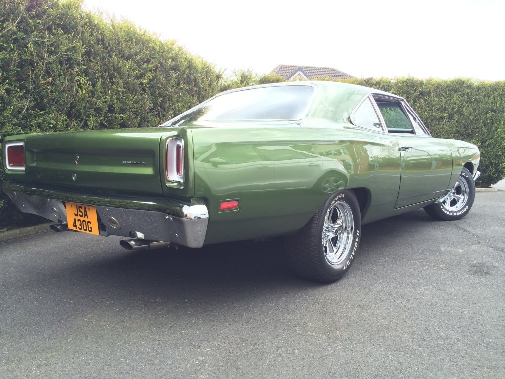

Well this is what I
went for in the end.
Cragar/Unique 177 Supreme Chrome 15 x 8 on the rear and 15 x 7 on the front.
Tires are 255/60R15 on the rear and 215/70R15 on the front. See picture

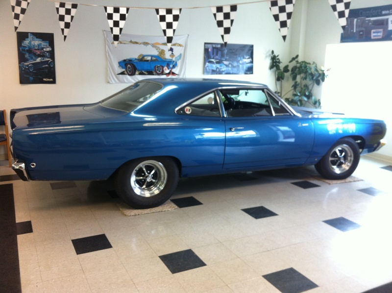

Here is mine with 15x8's front and rear, 245x60 -15's all 4 corners , I am in the process of getting some steelies and going to use the 275x60-15 nitto drag radials in the rear as a second set of wheels and tires for shows or fun or both. Becarefull with the mag 500's don't let them sit in the weather. My car was recently bent over by a douche bag body shop and they let my car sit outside for 7 months in our worset winter rain season in 5 years and the wheels all got rust spots on them around the valve stem and a few tiny spots where water was just sitting, I had to get the fine steel wool out and wd40 to get it clan but the damage it done. I am trying now to clear coat those areas so I wont have to clan and polish the rust spots every week. SUX!
