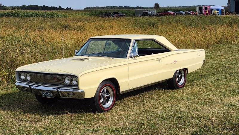

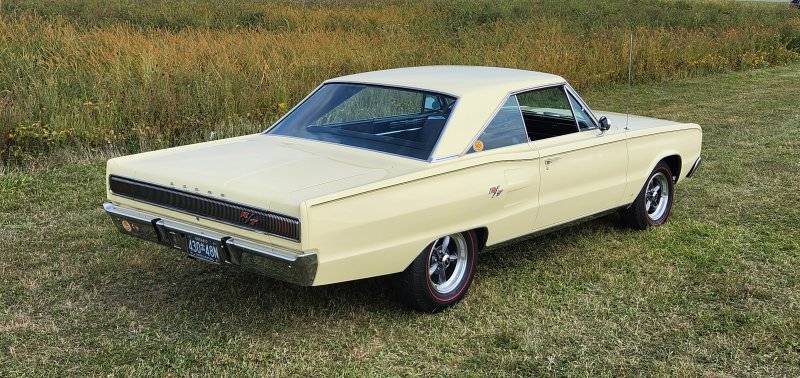

I bought 235 70 15 for the rear and 225 70 15 on the front of my 67 R/T. The only time I have had any rubbing is an entrance to a filling station that the entrance is a sharp uphill right. But is minimal as I have found no scuffing on the tires.

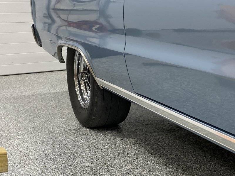

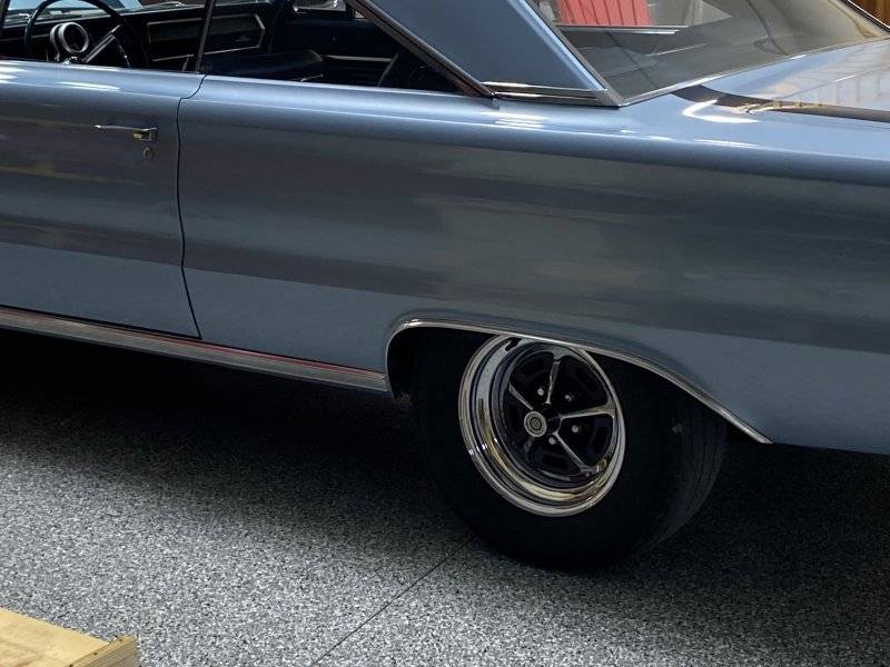

P 255 60s on 15 x 7s. Dana. The 4.25 back spacing on the Magnums is about perfect.
I bought 235 70 15 for the rear and 225 70 15 on the front of my 67 R/T. The only time I have had any rubbing is an entrance to a filling station that the entrance is a sharp uphill right. But is minimal as I have found no scuffing on the tires. View attachment 1899470

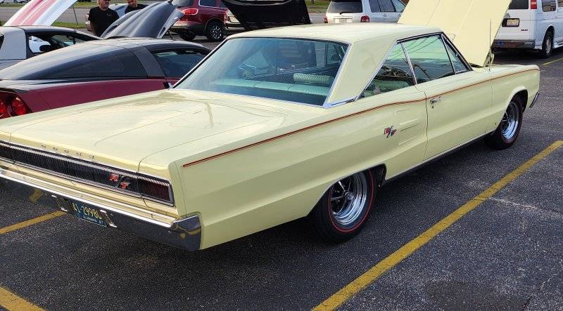

I found that 225 70's would rub the rear front frame rails on full turns, so now use 215 70's up front. I also have 235 70's on the rear. Nice car, Jerry! Here's mine.

Jerry’s car above is gorgeous too!
I’m walking through the Pits at the Nats. A yellow 67 GTX catches my eye probably 20 cars down field and 100 yards away. It’s the friggen color.
Sharp looking car Jerry, I do like the yellow. I had a Plain Jane Yellow 1966 Belvedere with a HEMI and it really stood out.
