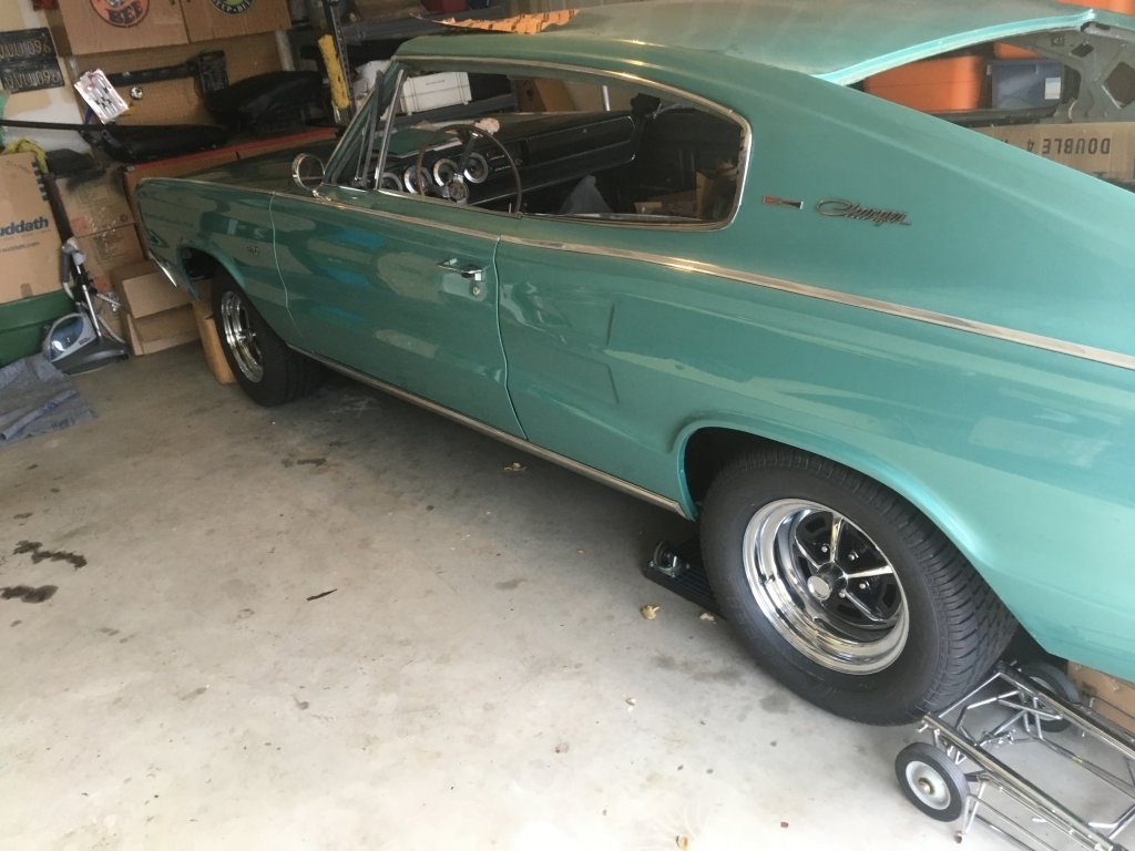

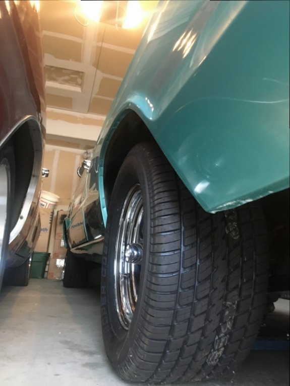

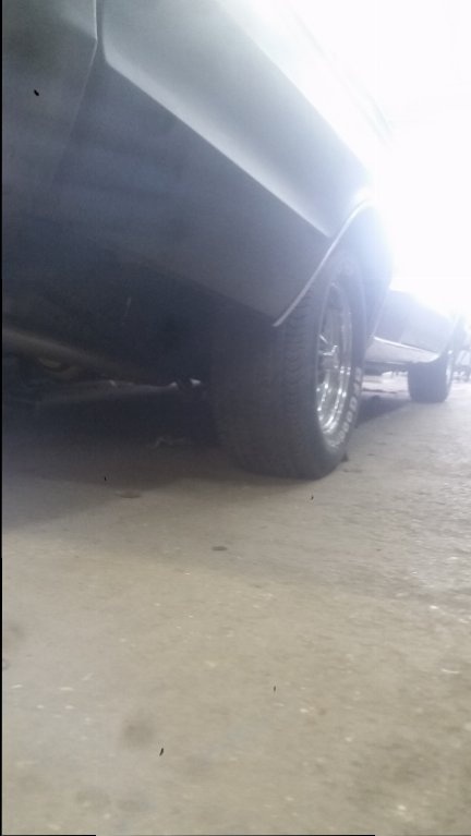

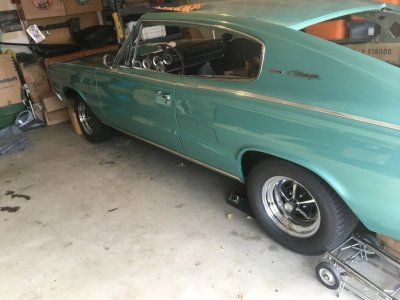

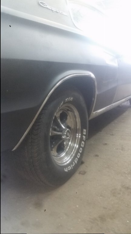

I have 15x7 slightly different 265/60/15 in the back which gives 9" of rubber on the road and 235/60/15 on the front
Had 15x8 magnums with 4.25 backspacing
295/50/15
245/60/15
Sold them went to 17 inch magnums to clear my 12 inch wilwoods
Thanks guys.
Looking at your pictures a 15x8 with 3" BS may not work if I want to use the 255/60, I may need to go to 4" BS.
