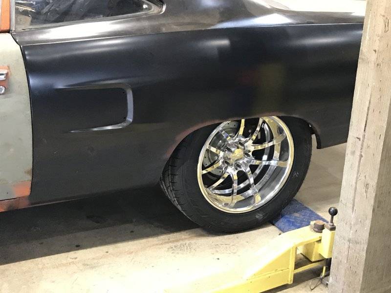

295/65-18 no cutting of lips or mods in any way

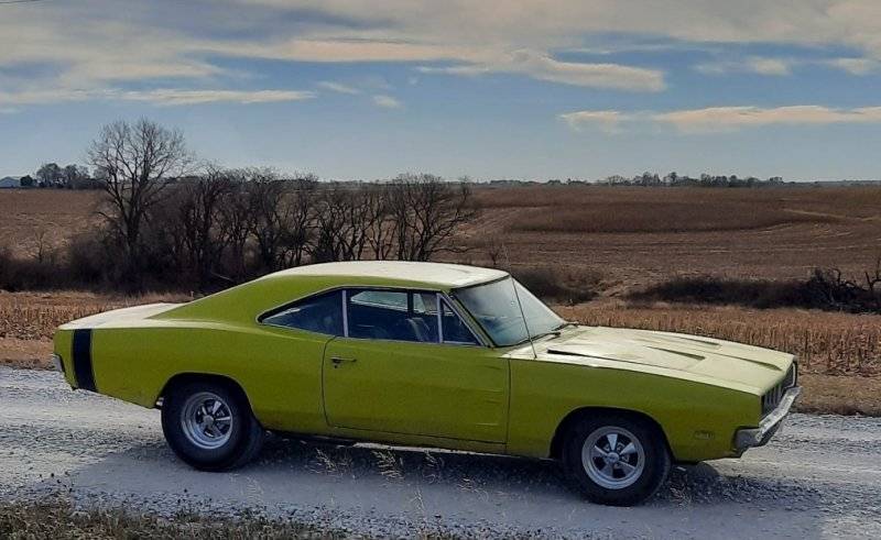

Awhile ago I had a 69 Charger and was running 295/50 on 15x10 rim and I was going around a long sweeping corner fast and hit a dip. Lateral force combined with spring flex caused tire to rub fender hard enough to spin the car. After that I went 275s to prevent that happening again.

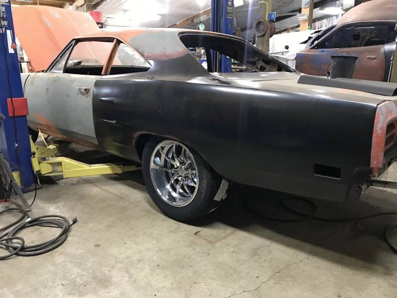

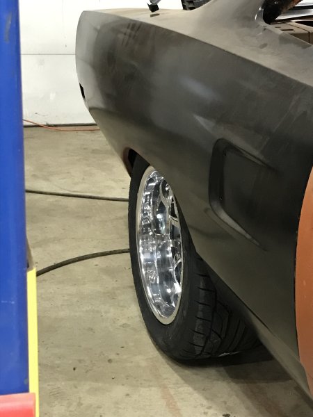

We have the 295/65r15 M/T e.t. streets on our 69 charger. The lower front corner of the quarter was previously tweeked with a hammer from when we ran 10.5x30.5 slicks. The rearend needs to go back 1/2" minimum to clear a stock quarter which is what I wished we had done. I think we have a 8" rim and a 4 3/4 Backspacing. A 5" would be better as it can rub the upper/outside of the fenderwell when we put more weight..i.e. passengers in the car. The 295 65 is tall enough a 8" rim works ok. On our other 69 charger the rearend is set back 1" for 31" tall tires to clear the quarter. This is w the 295/65s.

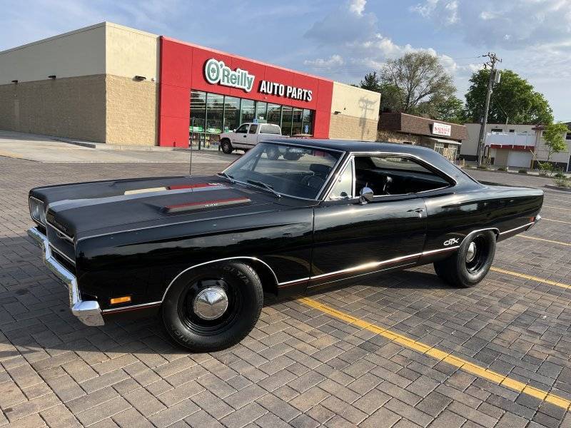

I have some 15x8 steelies with 4" backspace, that I put 255s on cause the 275 would have been too close to the fender (in a 62 savoy) Same car with 4.5-4.75bs has 295/55x15 equivalent on it.
