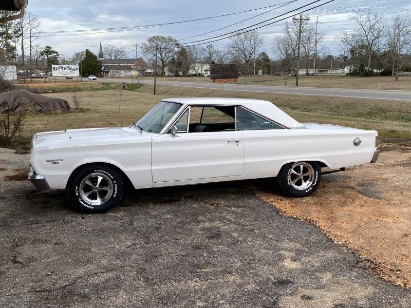

Anybody running this tire and rim setup, 245 60 15 square on 15x7 on a 67 GTX? Pics, any fitment issues?

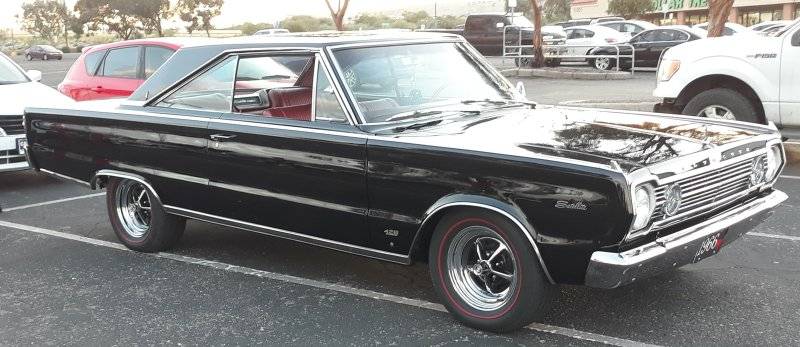

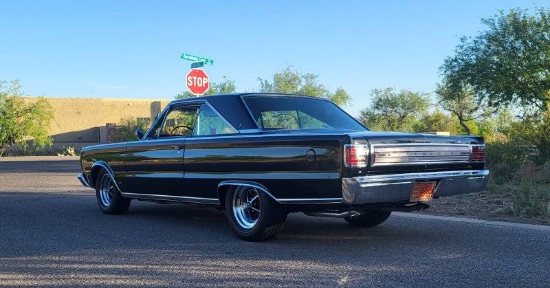

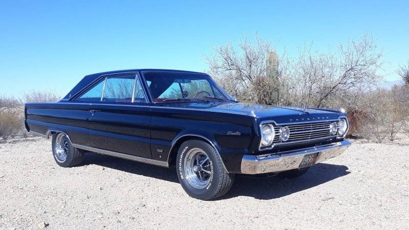

Yes they fit perfect on there!

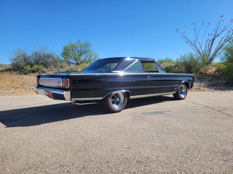

Just an fyi,
In my post above. the 2 pics on the top are recent versus the 2 lower and the car has had suspension work to lower the rear of the car slightly. If that matters

That size looks perfect on almost any car. Except I always like a little more tire under the rear.
