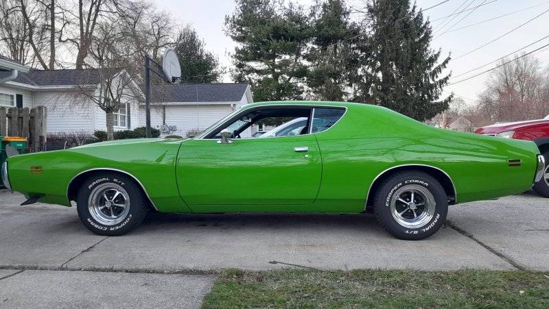

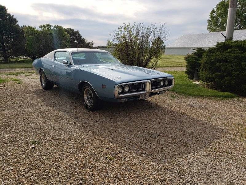

255-60/15 on 15X7 front, 275-60/15 on 15X8 rear. No clearance problems. I have manual steering so gets difficult in parking lot. Dana 60 with 3.54:1 ratio, 2500 rpm @ 60 mphCharger latest view.jpg

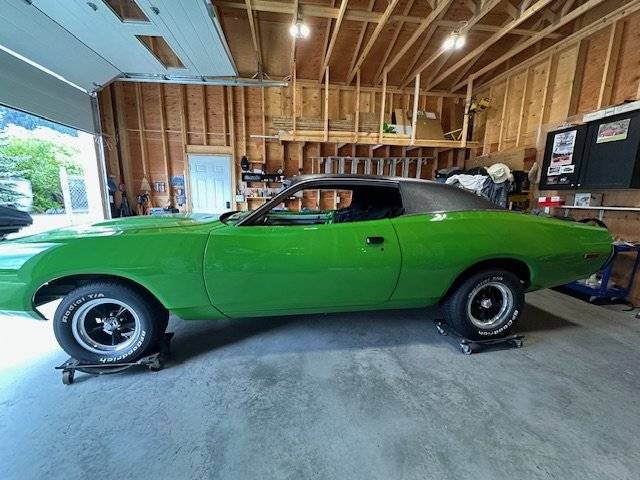

I have 23560R 15 on front and 25560R 15 on rear. Same sizes as the previous owner had but I have new wheels and tires. Project is still in progress and sitting on casters as you can see in the photo.
