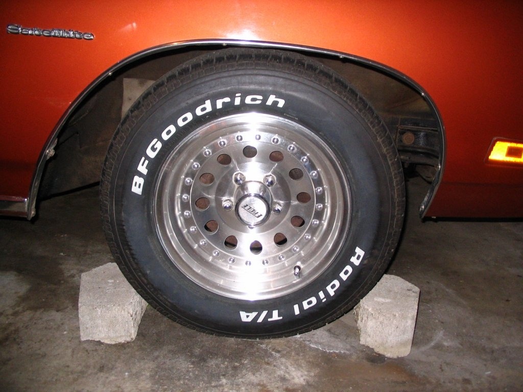

I have 235/60/R15 using 15X7 rims on the front of my 1970 Sport Satellite
