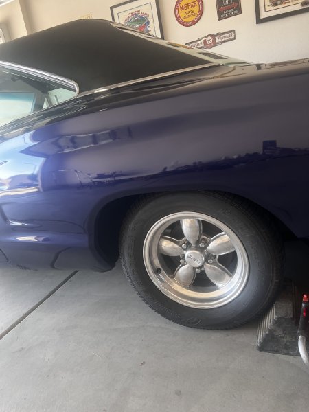

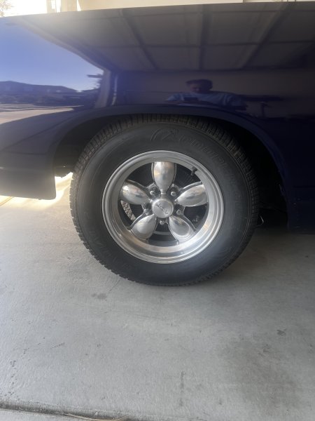

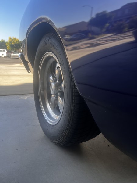

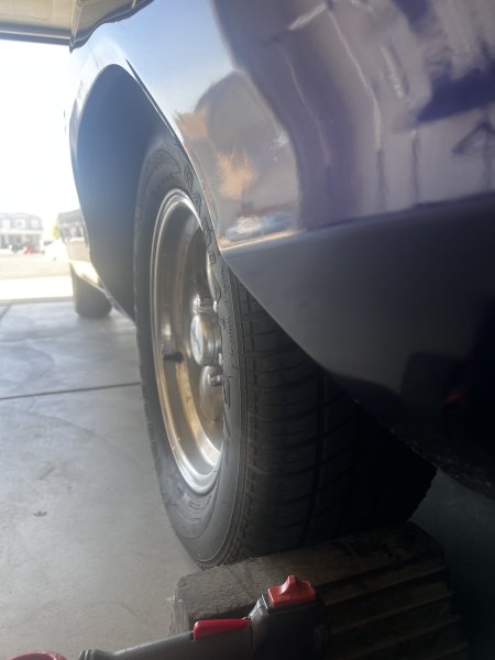

Hi guys I have a 1969 Dodge coronet the wheels are 15x8 currently the tires are 235/60/15 I was wondering would 255/60/15 be too big in the front? I’d like to keep the tires all the same size

How wide are the front wheels and what offset? Is the front of your car lowered?
I have 255/60-15 all 4 on a 70 Plymouth, fit fine on stock 15x7 rallies. No rubbing ever.
It’s 25 inches high in the front the offset I believe is 4.25 and they are 15x8

Theoretically, 255s will be just under an inch wider in section. Turn your fronts lock to lock see if you have clearance for a half inch more tire in both directions.
And the 4 1/4" on your wheels is backspace. Offset is a WHOLE different thing.
