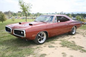

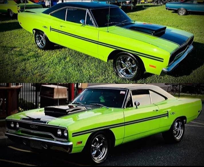

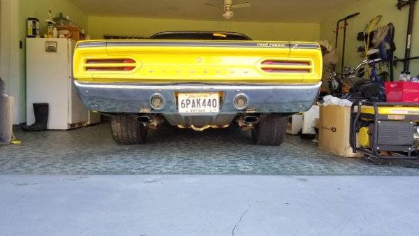

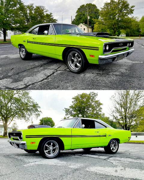

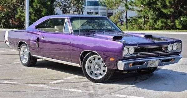

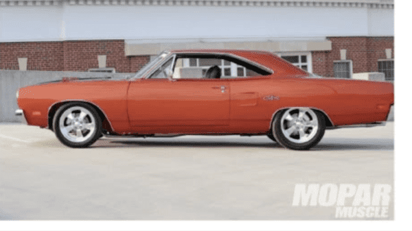

Looking to put some 17” wheels on my bee and I was curious if anyone had any pictures or info on what tires and backspacing they’re running for their 68-70 B-bodies. I found this thread in the wheels and tires section http://www.forbbodiesonly.com/moparforum/threads/b-bodies-with-17-wheels-post-your-photos.50869/

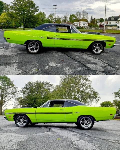

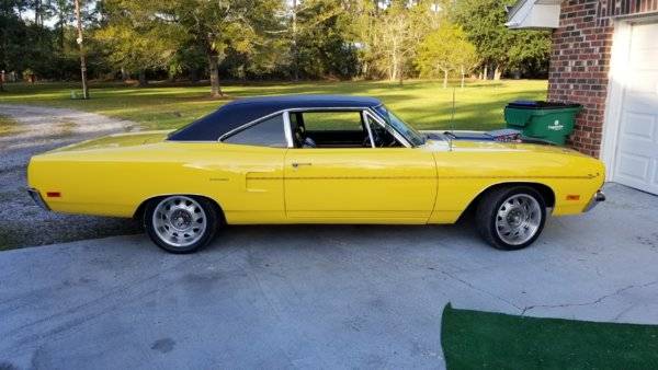

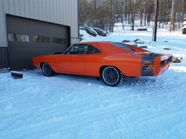

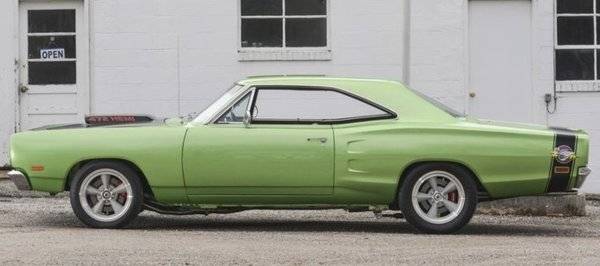

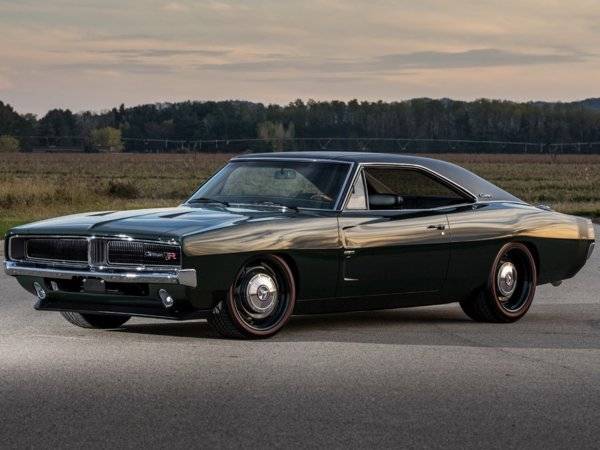

But hoping I can stir up some more info over here. Currently leaning towards 17x8 fronts and 17x9 rears with nitto Nt450 275/50/17 rear and 225/50/17 fronts. Unfortunately Nitto is the only manufacturer I’ve found to make a tire for 17s with a decent amount of side wall. I’ve attached a few pics of different cars I’ve found online to be running 17s or 18s.

I think it depends on the body as well. For some reason chargers just seem to look cleaner than the other B bodies with big wheels. I really like the look of the Ring Bros charger running the oversized black steel wheels. Subtle and an overal clean look.

315/35/17 Toyo Proxes TQ Drag radials on the back. Everything else is stock. ZERO rubbing. Classic Industries aluminum Rallye wheels:
