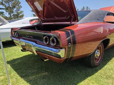

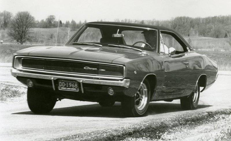

I know that the 71+ B is much different but to me, those cars always look like the tires are tucked in way too far. I'd want to go for as little backspacing as possible to push the tires out to the edge of the wheel openings for a much better look.
Some don't mind the tires pushed way in and that is fine. To me, the cars look more aggressive with a wide stance.
Note the way the rear tire is tucked in far:

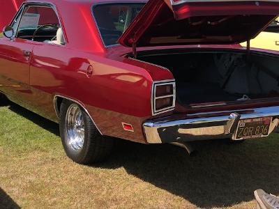

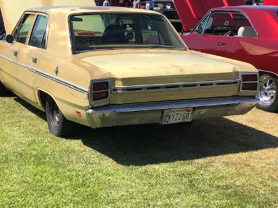

The Darts here are a clear example of that.
While I can appreciate this car for being stock, the car looks like an elephant with tiny feet.
