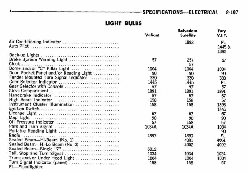

The 1967 GTX used ten #158 bulbs for illumination and indicators in the instrument cluster.
From the 1967 service manual:
#194 can be substituted for # 158. It uses slightly more current as noted and it is slightly brighter.
