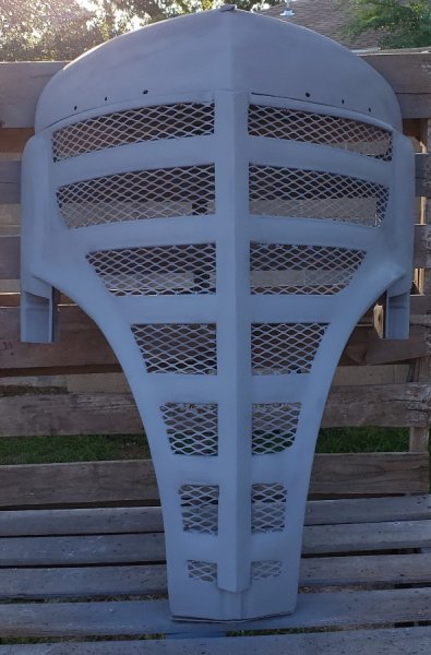

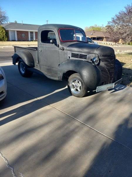

Here's my 1940 Plymouth.
The front grille was trashed
as this truck lived it's life on a
ranch in NM. We used an old
set of patio furniture to
rebuild the grille.
It never saw asphalt except
when driven to the ranch
from the dealership.

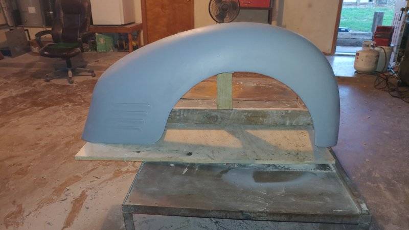

The frame was bent and
twisted. Replaced it with a
custom tube chassis with
8" taken out of the
wheelbase, shortened the
rear fenders and running
boards to get the proportions
right, and built a 6' bed for
it.
