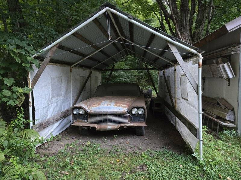

1958 Dodge Coronet

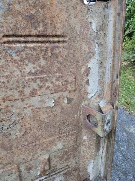

Got a rust free trunk floor from John Fowlie of Big M Automotive for our '58 Coronet over the weekend.
He said it was cut out of a rust free '57 D500 that was unfortunately parted out years ago.

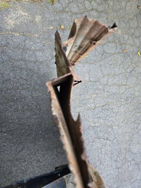

Looks like the quarters were cut off first, so I have a few inches to make up on the back sides.
It has the frame mounts, gas tank mounts, and rear double floor section I didn't want to attempt to fabricate, as I wasn't sure exactly what it looked like.
It will be nice to have a floor I can't step through and sever an artery.

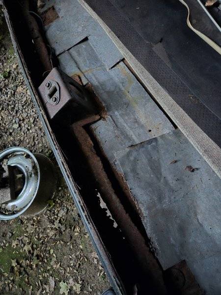

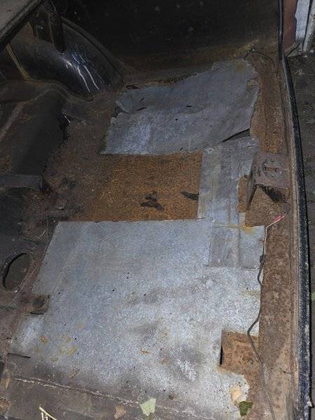

Did you make the floorpans?
My floors aren't terrible, just need to be fixed about 6" in from the rockers.
Not going overboard there, just flat sheet metal patches.
Car came with rockers, quarters, and other replacement panels, and I bought a trunk floor.
Passenger door could be better.
Pan was from a wrecked and parted dry-climate 4 door I was very lucky to find. I removed it whole and then split it down the middle to re-install. Even it needed patches in the front foot wells though.
