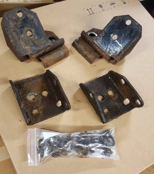

62 had a V8 k-frame and a slant 6 k-frame.
Engine mounts were different for 318 vs big block, but both had the same intermediate steel mounts.
Pic shows intermediate mounts on top, 318 engine mounts on bottom. There would be a rubber biscuit between them.
I would think there would be numerous options for your choosing of complete bolt in IFS with a K frame.
