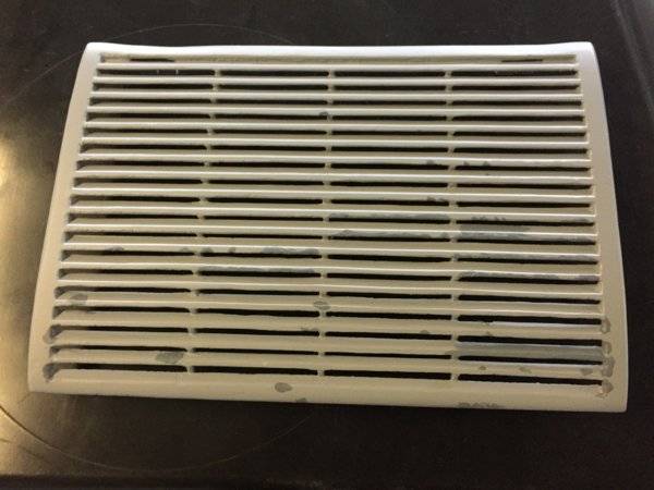

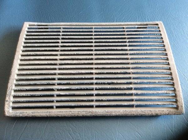

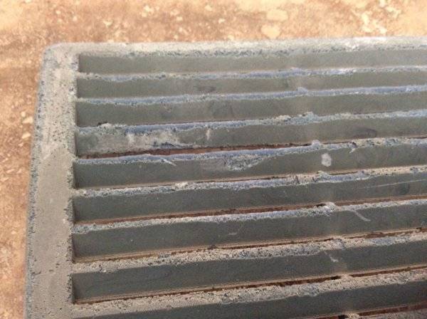

rebuilding 62 Fury plastic speaker grill. Started out building it up with Gorilla Super glue. Now we are spraying it with multiple passes of hifill primer and lots of sanding. Long process.

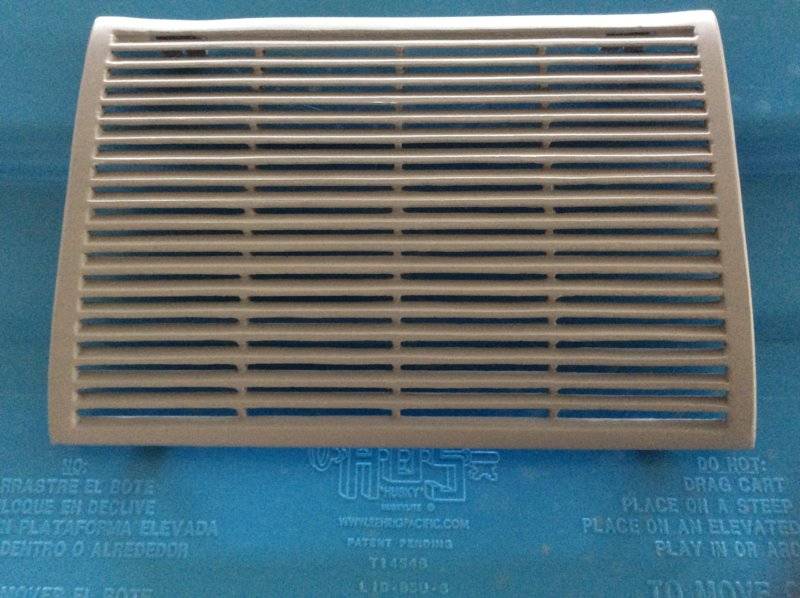

Think we are pretty much done. Two and a half containers or Gorrilla Glue, can and a half of Hi Fill primer used. I think one more sanding and finish primer and paint!
looks amazing can you do mine now? lol
Really nice job you've done. Hopefully someone will repop these again.
Thanks, never looked for a repop. I am on holidays with nothing to do so it was fun! For sure I’m not a body man so small project is good. Hope it doesn’t fall apart!
