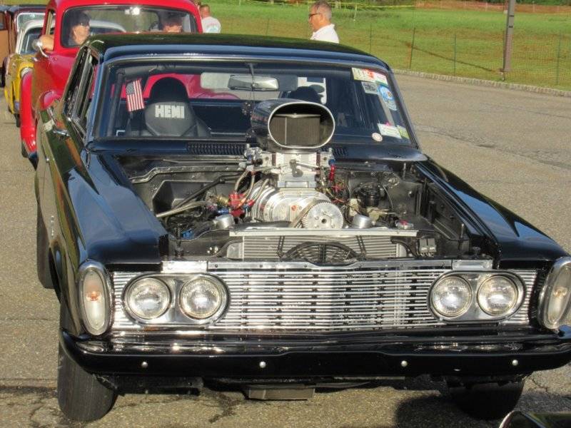

Might be wrong but I would think the '63 would be narrower than the '64.
Where's @glassman
Here I am ! Front bumpers and fenders for the 63or 64 Plymouth are not the same. Hood looks the same except where you put your hand under the front to unlatch the hood. I make the fiberglass hood, fenders, and bumpers for both cars and the front lower valance for the 63 Plymouth. Plenty of hood scoop combos too! We have package deals
A high school buddy in early 70s installed a 63 Plymouth hood & fenders on his 64 Plymouth. He couldn't find 64 Plymouth parts. I prefer the ,look of the 64 front end.
