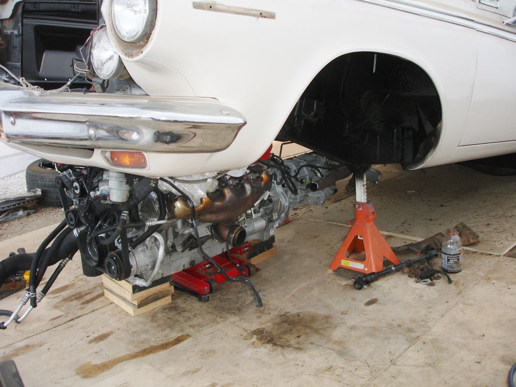

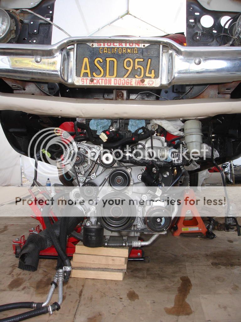

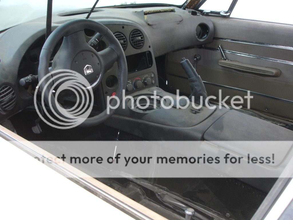

I'm working without a lift..........so I raise the car front end up and down as I work on fitting it. Here is an early pic:
Another:
Detail from pic above.........original 63 YOM CA black plate.
Not sure if I will restore or leave crusty

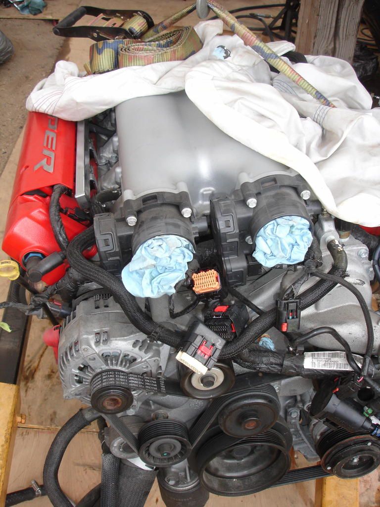

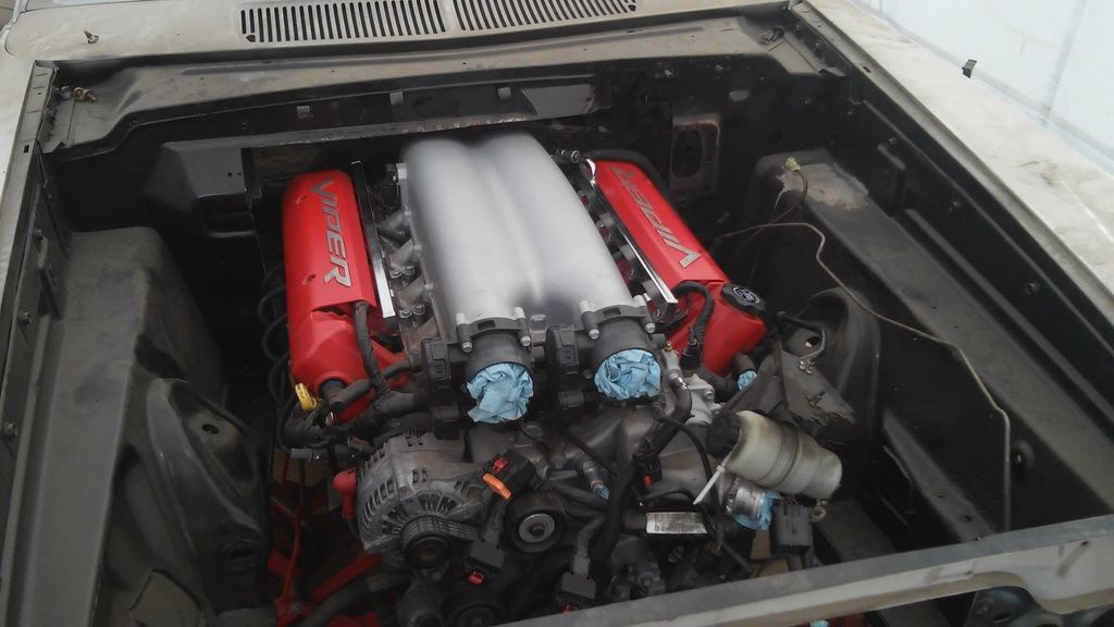

Duel electric throttle bodies...........hate 'em. I may go with an older intake and single w/ cable..........someday........
I lifted with a strap b/c it is less likely to damage something than a chain.............b/c I do not have the lifting brackets.

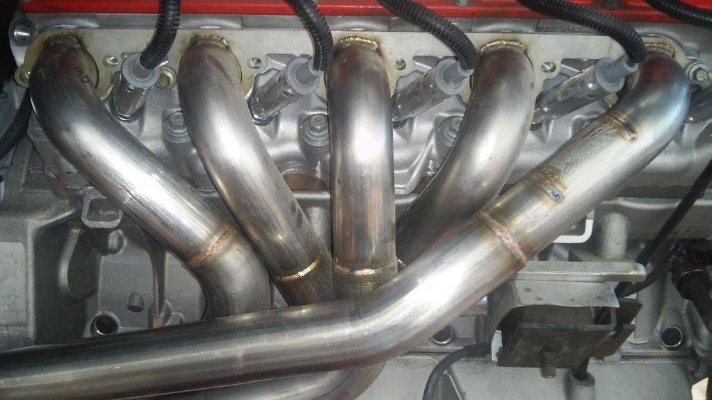

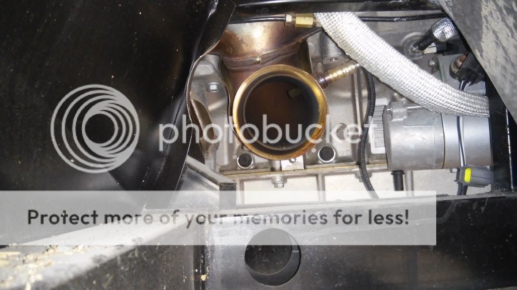

Manifold outlet as big as the starter.................but gone now.
The Viper manifold is a header despite the look. Inside of the heat shield are individual pipes.

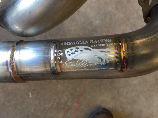

Challenger Drag Pak V10 stainless from American Racing...........not so cheap......

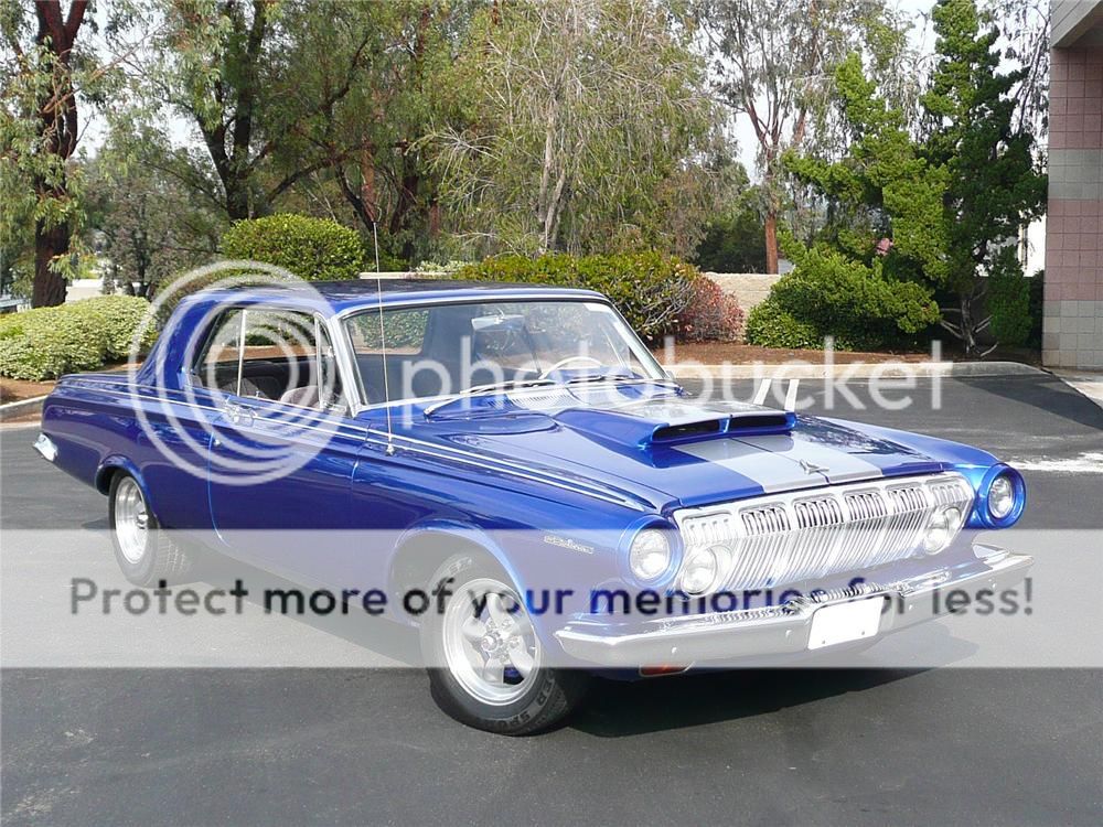

......Sonny loves this...also '63 Dodge/B Bod.....but the yellow????
why not take a look at Eric383's color...it is hot looking & correct.

A Bee is yellow and black...........and is ZAP!
I like Plum Crazy, but not so much on this body.
I considered going back to the stock 2 tone, but..........bland.
I also like:
What I do not like for this one.................BLACK....hell & no

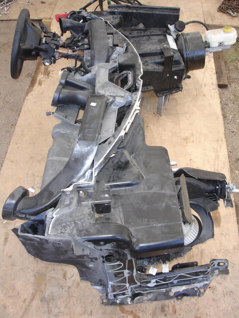

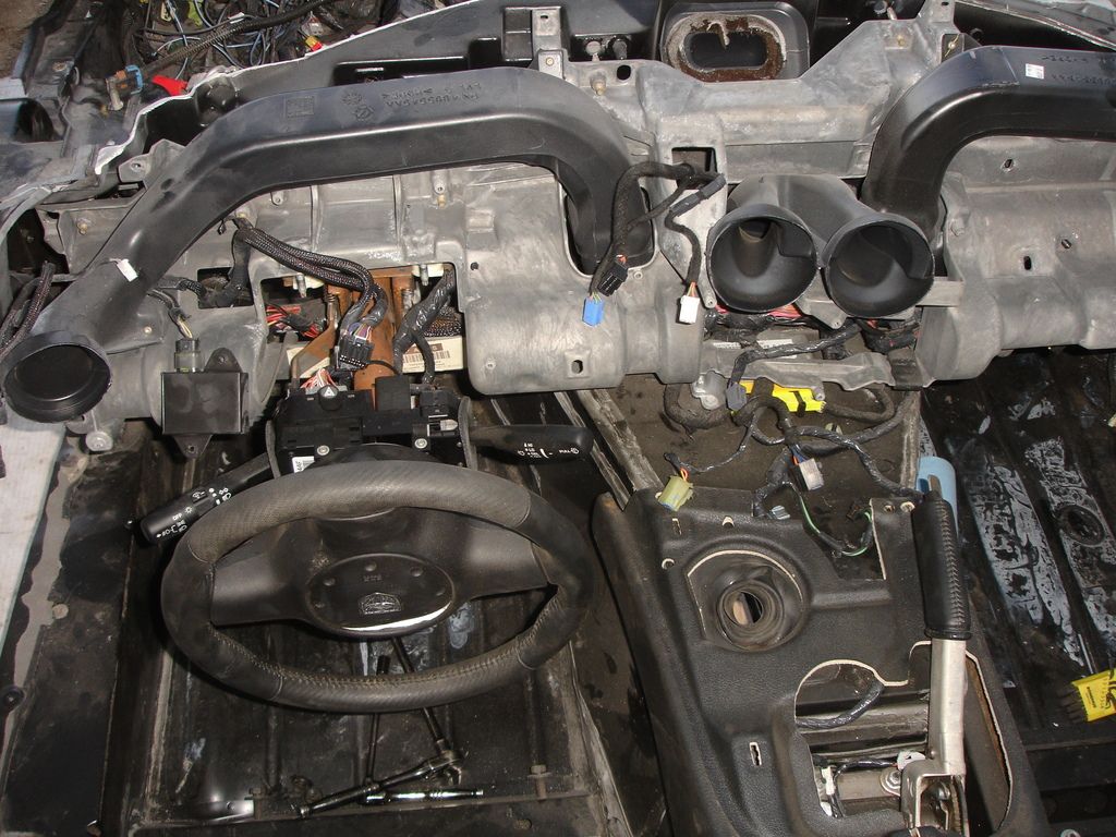

Some stuff in here we do not need..........was interesting seeing how the Viper is engineered.
I found what I expected in a modernMOPAR............some "that's really cool" right next to "what the hell is this all about?"

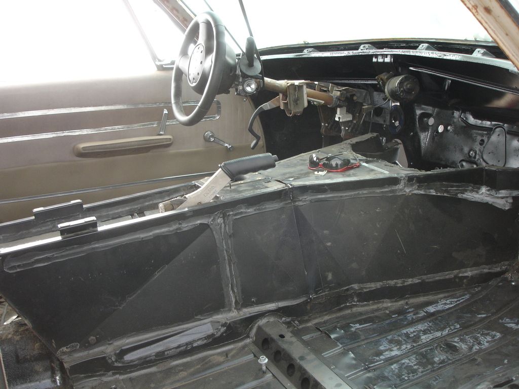

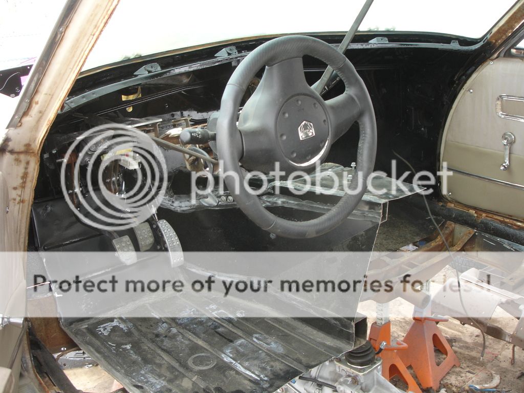

Early mock-up of front section of pan
It's a bitch, but I wanted something diff..............it is............
And both ..........
Big ol hump........

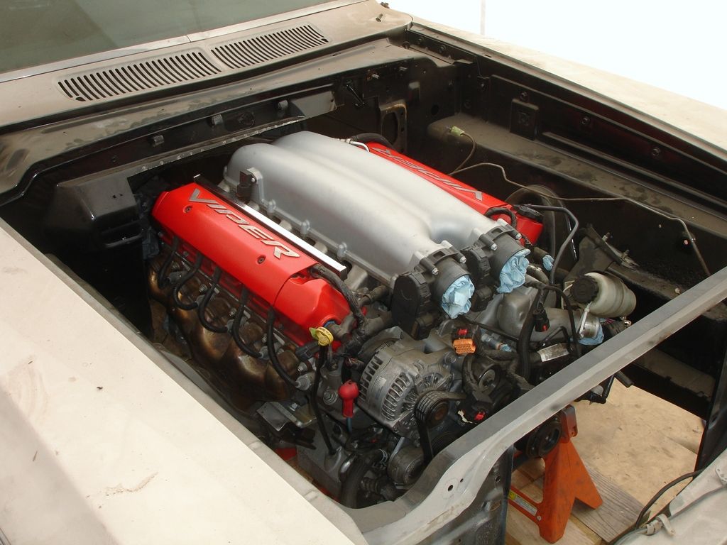

Engine bay seems to have shrunk..............
Of course all this did not happen in the last few days. I went at it a couple months and stopped a couple months.......so this is about where we are now.
This is pretty close to the final position.....just about an inch more up and to the rear to go............
Once I make my mounts I can then fab the new firewall and other surrounding bits.

Just my opinion too but I'm liking that Viper Blue over the yellow. But if you go yellow I think it could be less overpowering based on your wheel choice.
