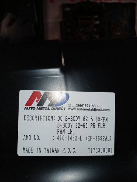

AMD stop making the 62-5 pans. I've been out of original pans for a while now
The rear foot well pan is different for the longer 63-64 Dodges. All the other pans are the same for 62-65 as are the frames.

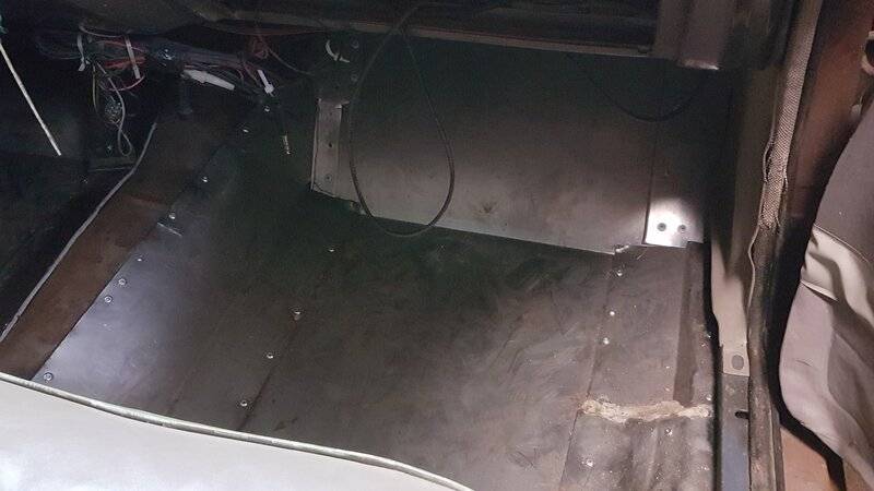

I don't know if you could get enough strength with what you have there Mike.
Frame connectors with cross bars maybe, but, well...

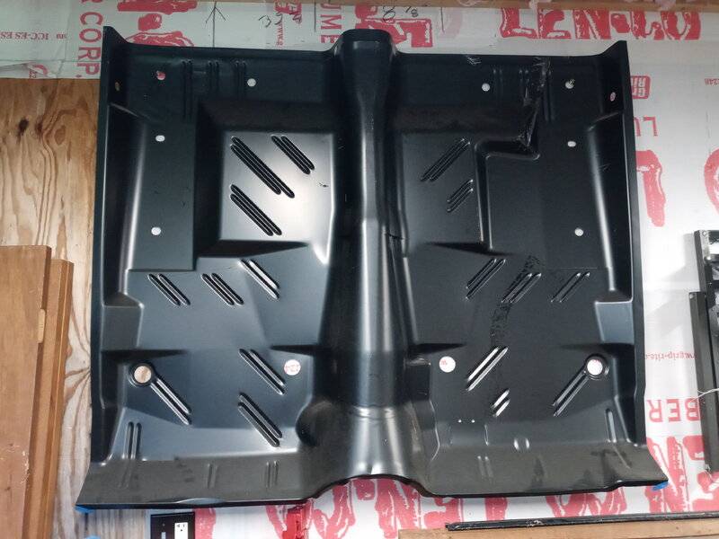

Looking at your photos Mike, I think that you might want to go with the full floor if you can, as it has the trans tunnel. The install also might be easier. I live just down the road from you, and if your interested it cost me about $2000 CND to have my floor dropped to my front door. That included the floor, shipping, exchange rate and the taxes and duty.
