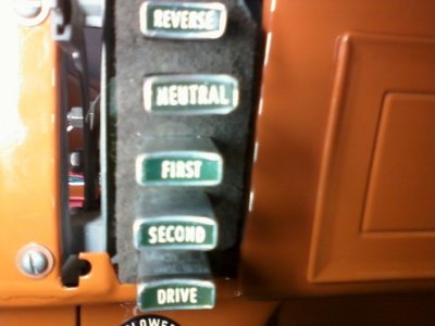

I am getting into interior resto work on my '63 330. The push button controls, for the transmission, and heater selection settings are kind of worn, especially the PARK & DRIVE buttons. Does anyone know of availability with replacement on these, or happen to have any NOS, or a very nice set of used slide covers. I need a total of 9, 5 for trans, 4 for heat control. Hoping I can remove the metal jackets, without damaging that 50 year old plastic. Any replies appreciated...Thanks
I dont know of anyone who makes them. If it's any help, 1962 is the same and I'm thinking the button covers are the same on a 1964 also. (Looks like the same shape)
I bought several used sets, here and there. The first gear and second gear button covers are normally in good shape because they hardly ever get used.
Call Joe Suchy in Georgia. He'll have them. Might have to goggle him. Don't have his # offhand
Drill the little dimples in the sleeves and they slide right off. Then you can sand and polish them. I learned this when I figured out how to revise mine for reverse manual valve body.
