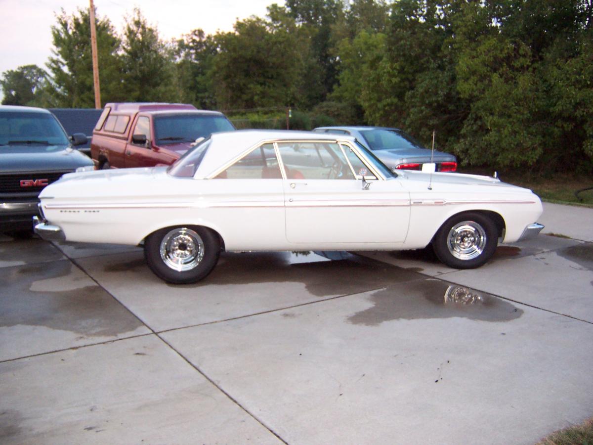

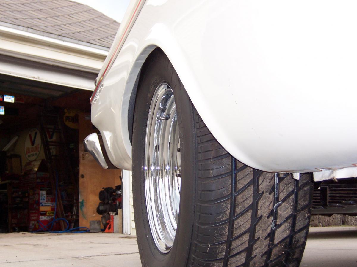

Here's another example: 15X8" with 4-1/4" b.s and 255-70R15 tires on the rear,and 15X5" & 205-75R15's on the front. After some driving,I do have a slight rub mark on the rears,but very mild. A wheel with 4-1/2" or 4-3/4" b.s. would have been better in my case. There's 3400# SS springs on the back as well.
I'm running 275x60x15's on the rear .. on 15x8's .. 4 1/2 bs .. have room to spare about an inches each side
