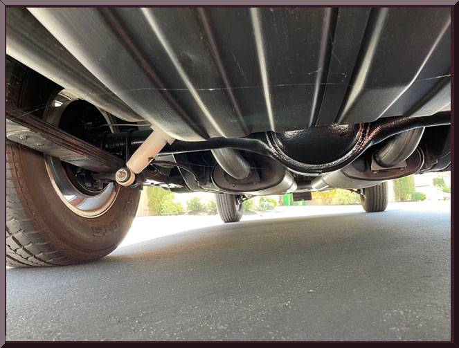

If you look at the very front of this 63 Fury you can see the oil pan sump
My question is this is a larger then stock pan as I don't think a stock pan would be that low under the car.
Looks like a bigger sump. How many quarts does it take to fill when you change oil? Stock pan is 5 quarts with a filter.
Not mine but I'm considering buying but have to wait for owner to get back in town. Just looking at his pictures and trying to spot things. It is a Max Wedge clone 63 Fury
This is a stock early B big block oil pan. Stock max wedge pans didn’t hang down like the one in your picture, either.
As you can tell by my questions I don't know much about Mopars.

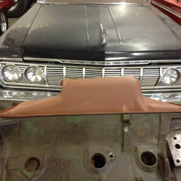

Absolutely. Looks like the Milodon I used on my '63 330. 7qt sump. I trimmed mine to pick up 1-1/2" ground clearance, still holds 6qts.
Maybe why the torsion bars are cranked up, the front is higher then the back
Based on the picture I'd say 8" or so clearance
