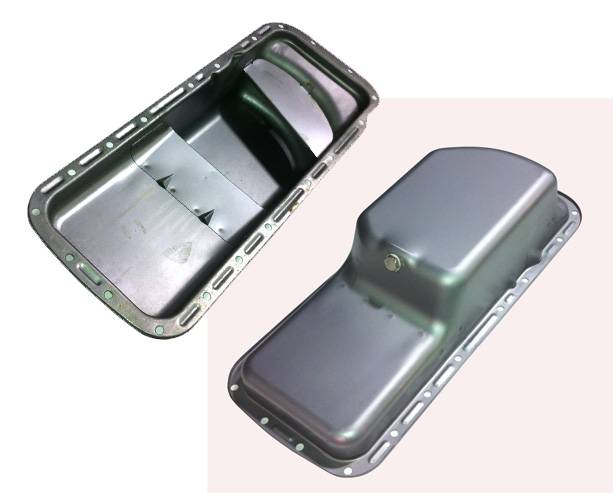

does anyone know if the 440 source pan and the milodon six pack pan are the same or summits hemi oil pan
Summit Racing™ Stock Replacement 426 Hemi/Mopar 440 Oil Pan SUM-G3511​

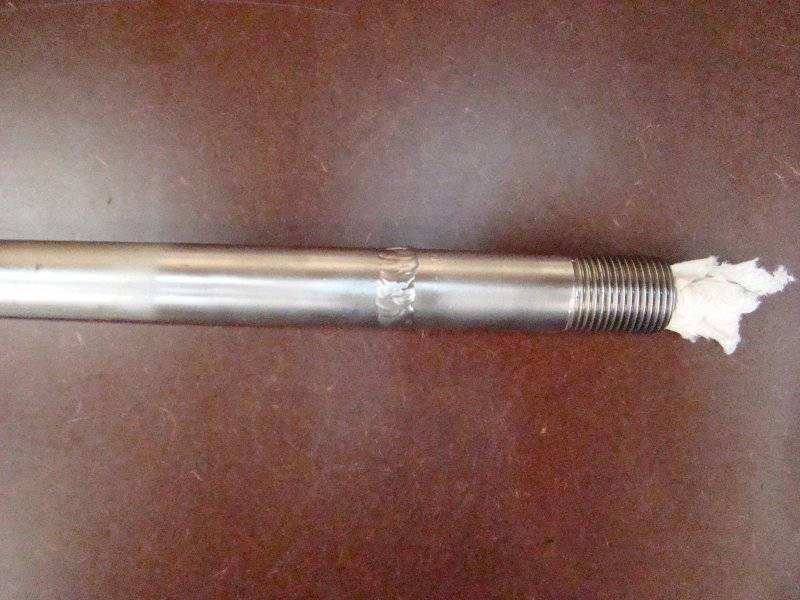

I bought two pick-ups and made one long enough for the girdle and scraper.
On the Chargers 500" stroker with BCR caps and girdle, I used seamless 4130 chromoly tubing pulse tig welded to a strainer cut off a milodon pickup.
That Summit Racing 6 qt B-body (& E body IIRC) Hemi/B/RB oil pan
you can get either a 3/8" or a 1/2" pick up for it,
it's for all the above BB Hemi & Wedges & can be used on all the above
not sure the same number as listed above, but should work
may want to check your drag link see if it will clear too
you may want to check for connecting rod/bolt clearance for the windage tray too
may have to go to a deeper windage tray
they make one, windage tray in composite at Summit
with formed gaskets on it already

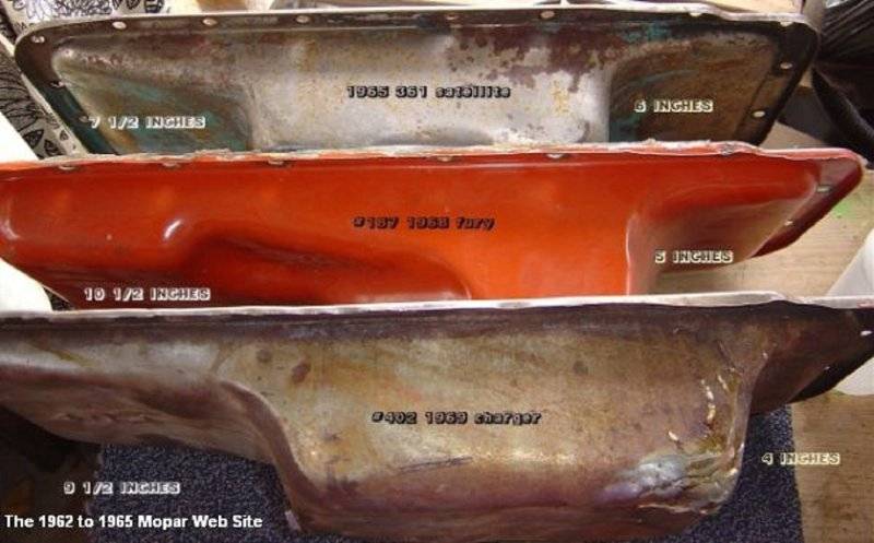

old shot of dimensions from sump front & rear top 65/361
middle #187 68 Fury
(both top 2 below are irrelevant to what we are talking)
bottom modified/repaired #402 for a 69 Charger

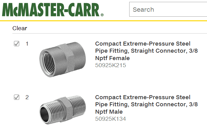

I'm gonna' try these to lengthen a 3/8" pickup over winter...
Maybe some dimensions will help....
