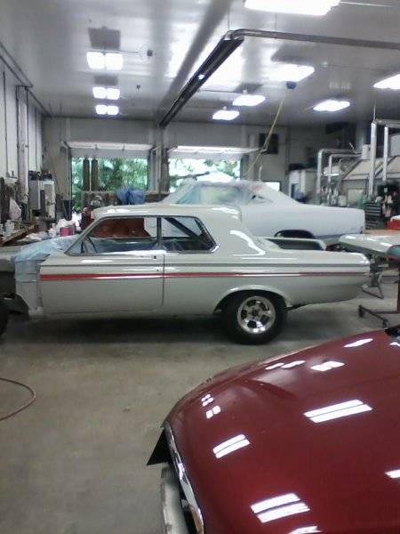

Selling my '63 Fury .. a guy asked " Does it have the original 8-3/4 rear end with the >splined axle and nut on the outside ? <. What am I looking for to id. this. I know its an 8 3/4 but don't know what he is referring to by splined axle nut and how to tell ..they were used prior to '65 and I guess he wants to know if it's original...thanks.
big nut in the center of the rear lug nuts.Hard to see but the only photo I got.
OK I got it..didn't know what the hell he was referring to, thought 8 3/4's were all the same. thanks
