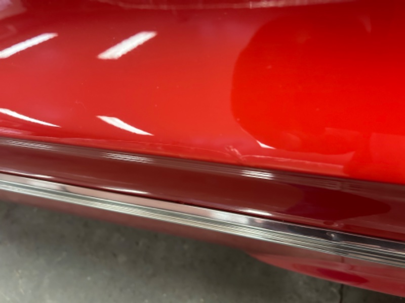

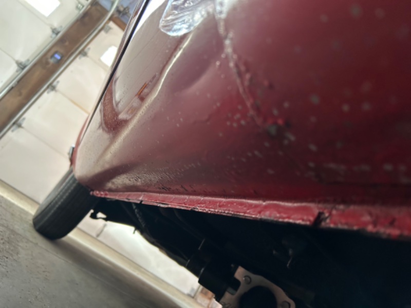

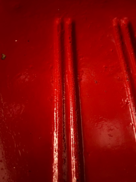

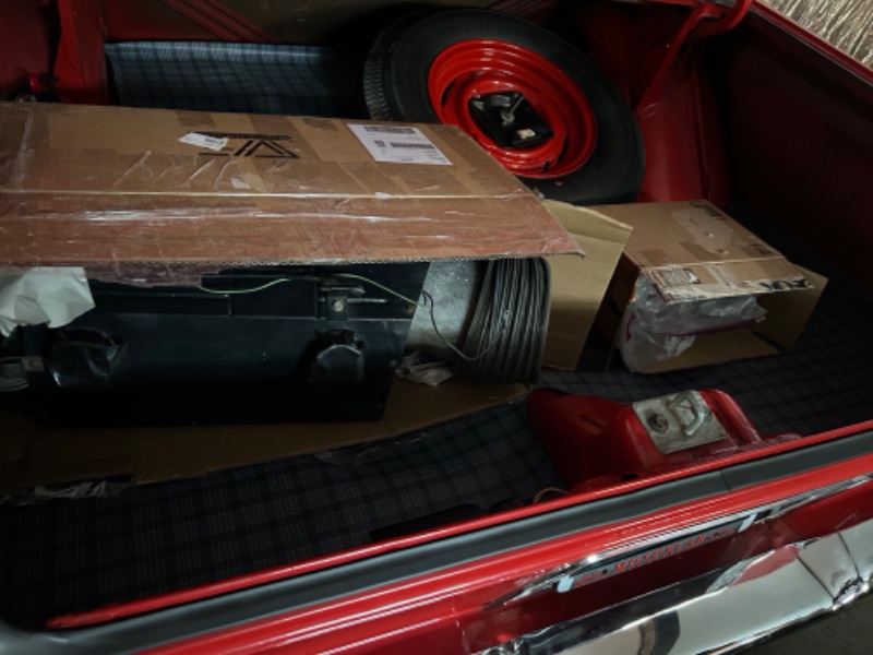

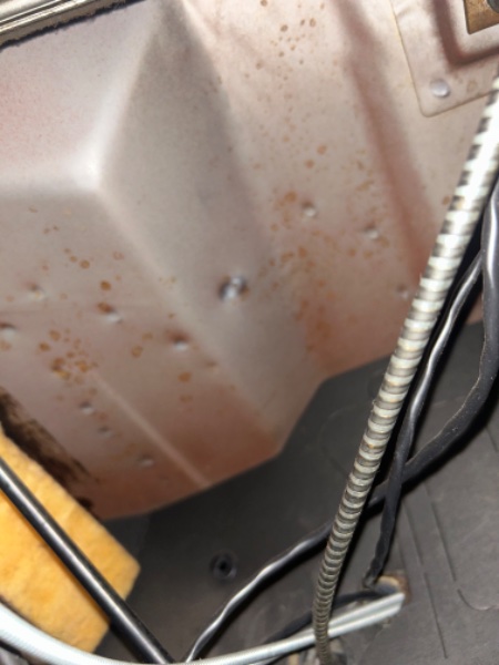

The car will need to be repainted as it is showing signs of its age; a few dings, chips, etc., which I kind of suspected before going to look at it. The car, at least to me, appears very solid. My cheap refrigerator magnet stuck everywhere with no issues. Looking at the cowl from under the dash, it appears almost new. All the trim is there and the grill is in very good shape. The interior and headliner are in very good condition. The only questionable area I could find was the trunk floor. It appears to be a bit pitted under the paint but very solid. All the lights work. The dealership replaced a few of the brake lines, changed the oil and gave everything the once over before I took delivery. The engine is running extremely rich and will need to be addressed. The heater box is missing but I scored a really nice one online.

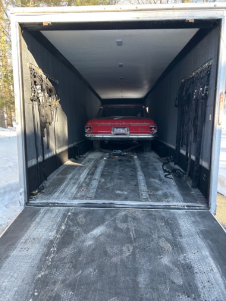

Delivered:

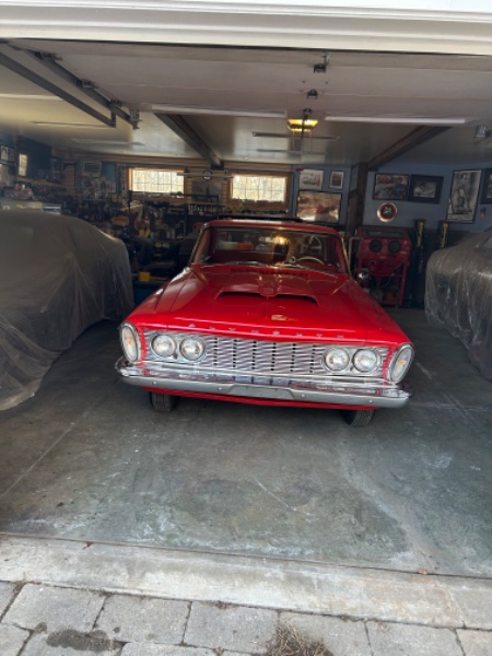

It’s new home!:
Replacement heater box:

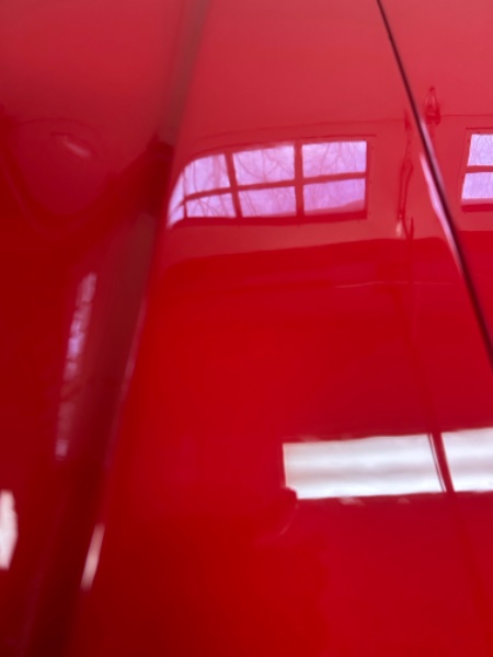

Dings and things:

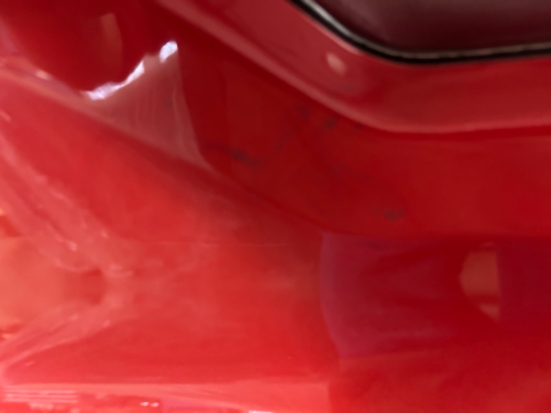

Weird spot of off-colored paint??:
Trunk floor:

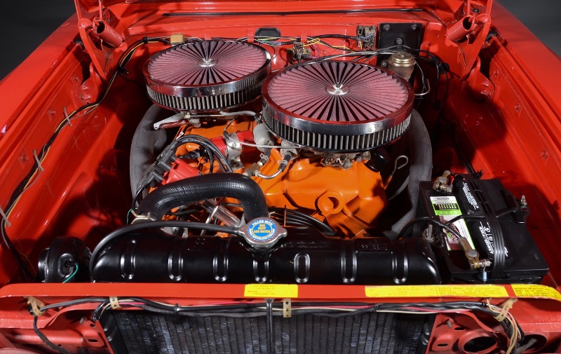

I would like to say, please get the correct air cleaners for your car. Otherwise, it's a beautiful car and wish you many years of enjoyment.
And remember, you know all the things needing fixing, not the average person who sees the car. Ruffcut
Thank you. I’ve been looking for the air cleaners. No luck so far. Mancini is out of stock on their repops and don’t know when they’ll be getting more.

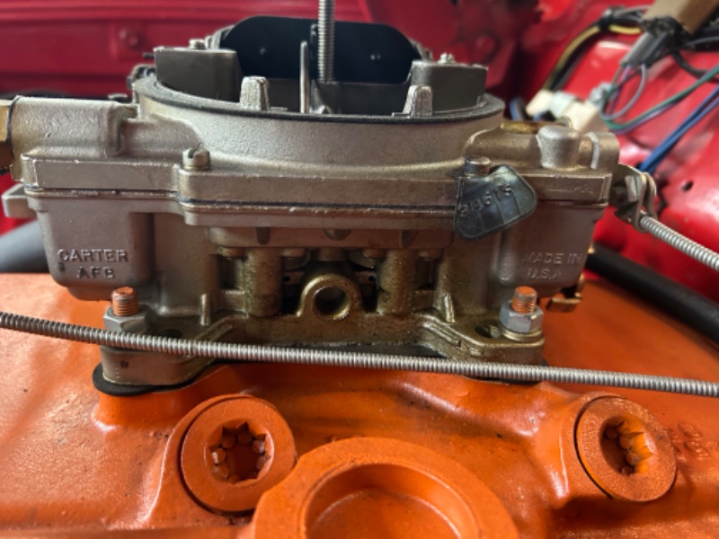

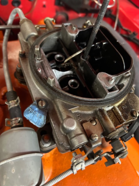

I think that your rich running Wedge could be a combination of your cool Mass. climate and no exhaust heat to the intake and carbs. Let things warm up before passing judgement on it. I gave this advice to my '62 Dart friend early last year, and I was right. But then, it sounds like the car has sat for years, so, maybe carb refreshes are in order. Real Carter 3447's or 3705's, or Edelbrock's?

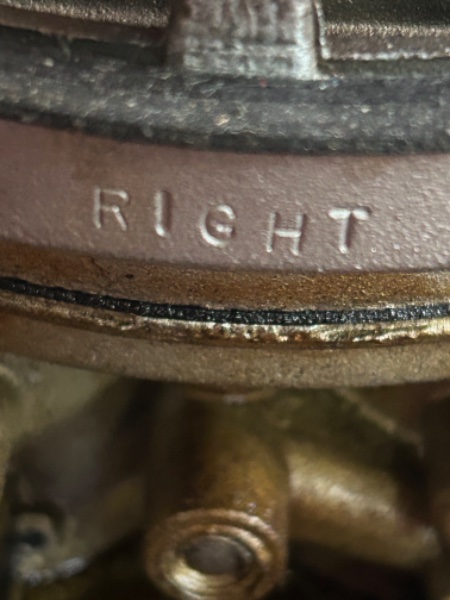

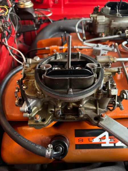

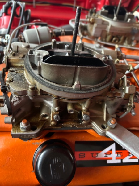

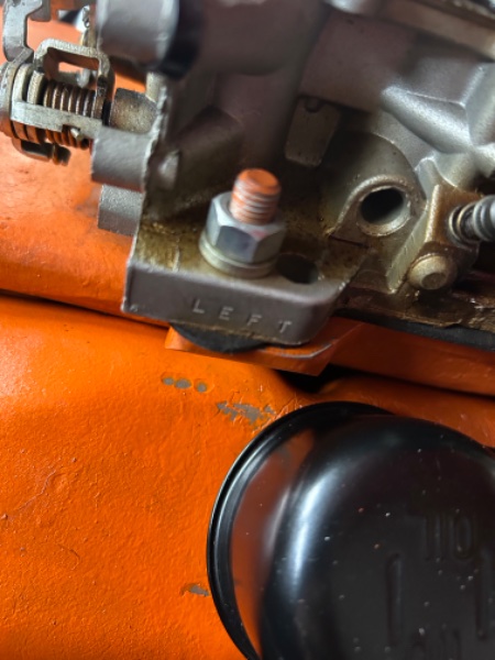

The carbs are Carters. I’m not sure which ones though. Looks like they might need a rebuild, leaking a bit? It looks like the chokes are zip tied open too.

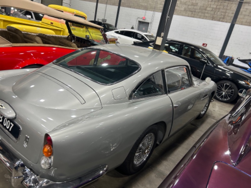

On a side note, the dealership I purchased the car from , Motorcar Classics, has two huge warehouses of cares, mostly high-end exotics; Ferrari’s, Lamborghini’s, Porsche’s, etc. They also had several vintage cars, as well. 3 of George Barris’ cars; The Batmobile, The Monkeemobile and the DB5 from Goldfinger that was used as a publicity car for the movie. All signed by Barris. The DB5 was pretty cool but an electrical nightmare. Everything, the rear bulletproof shield, rotating license plate, machine guns, etc were all wired to a massive relay in the trunk, looked like a rats nest. They also had a few cudas and a really nice Grand Wagoneer. You could spend a day or two just looking at all the cars they have. Here are a few pics I took. I was trying to stay focused on my car so I didn’t take many pics of the other cars.
Here’s the DB5, you can see the Monkeemobile next to it:

The carbs look to be later AVS. The factory carbs would have had cable-operated manual chokes. Someone has stamped LEFT and RIGHT on them. Luckily, the carb tags are still there, so you can order rebuild kits for them.
