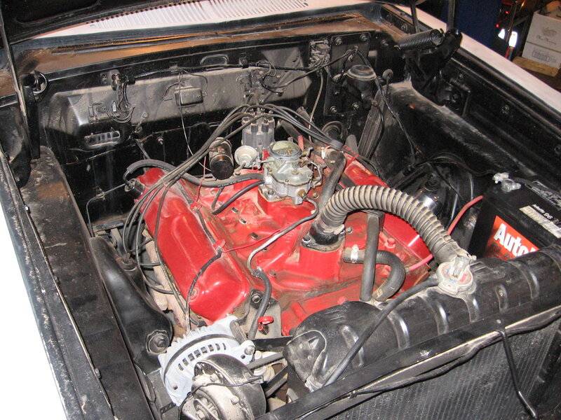

New Fury, not sure is this a regular 318 or the poly?

Original 318 engine would be a Poly for 1963. Never know whether it has been changed in last almost 60 years. Pictures?

Look at the drivers side of the block from underneath and it will be easy to see the casting numbers. There is plenty of online access to casting number databases
If it looks like this it's a Poly 318. Might even have a 361 "B" engine if the distributor is in the front !

Yep would be poly unless it was swapped out. Look for the cool serrated valve covers...
