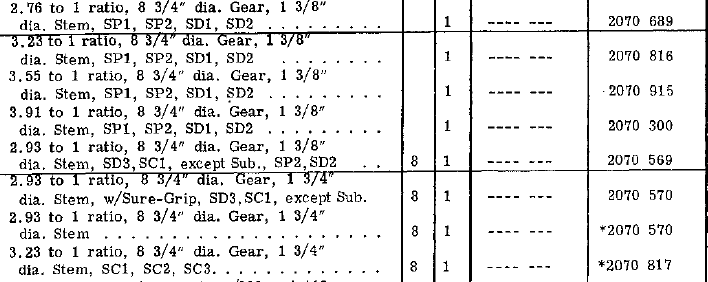

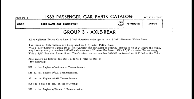

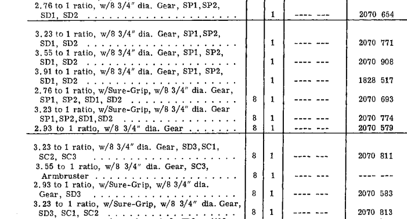

Looks like 3.23 to 1 is most likely, without getting under there to confirm.
