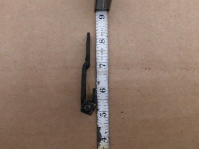

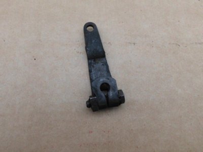

If you're still looking, I believe this is what you need. Came off a 63 Plymouth. Your choice certainly, but for what it's worth I bought a car a few years back with the Lokar kick down kit and absolutely hate it.

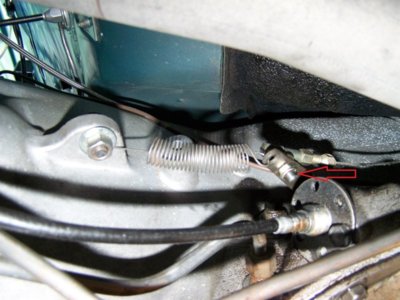

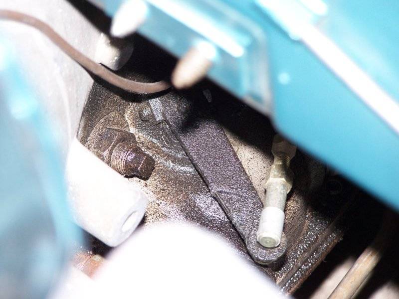

Here is a pic of the KD arm in my 64 BB wagon. The arm is pretty much straight.

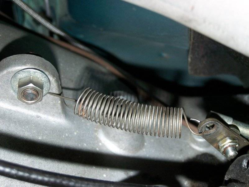

I too have the Lokar Cable, but it never really shifted correctly. The 2/3 shift would often be too late. When granny driving, I would have to let up on the gas to get it to shift in to 3rd.
After reading a lot about Lokar KD cable issues. I finally did something about. I removed the arm and drilled a new hole about 3/4 closer to the pivot point. Moved the post to that new hole and added a return spring. I reset up the cable adjustments and what a difference.
The trans. up shifts as it should. I'm into 3rd by 25 mph when granny driving.
