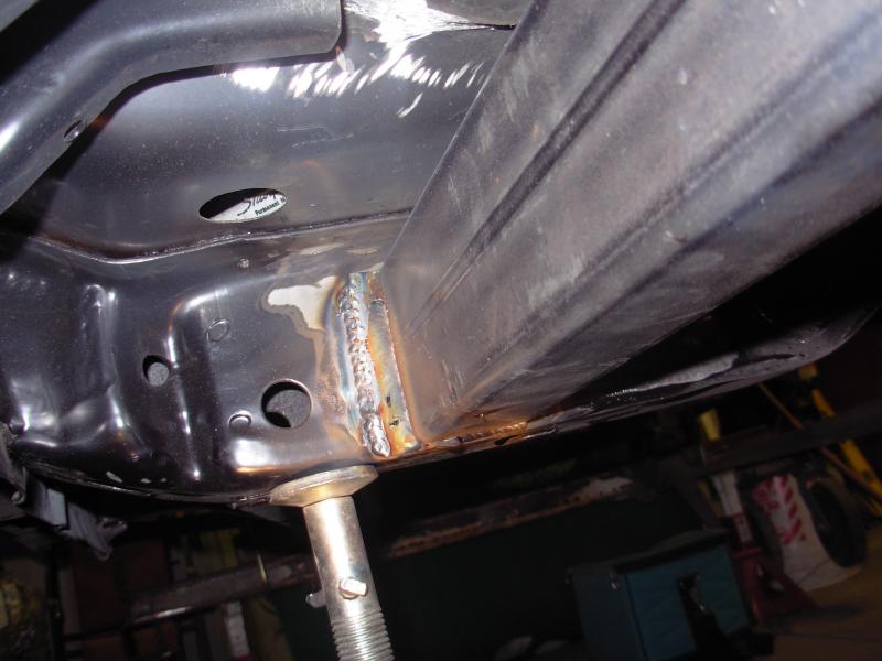

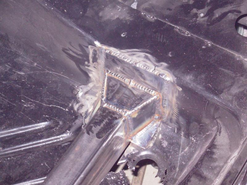

Here are some pics.The first pic is the basic idea of attaching to the torsion bar crossmember.The second pic is of thru the floor type connector and its attachment point to the rear frame rail.You don't have to get fancy,just simply plate it and attach.Hopefully this gives you an idea of how and were to attach.Sorry I can't find any under the floor subframe pics.I have a few discs to go thru,these were on the computer.
