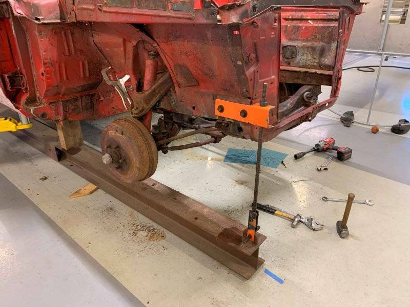

The front end of my Roadrunner was tweaked a little too, I straightened it this way. They actually bend pretty easy.
My exact thought also.
