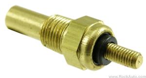

Sup y'all? New to the a Forum game. Temp gauge on my 64 will run dangerously close to the H with out actually over heating. It vexes me. Should I be worried?
Welcome. First you have to determine if it is really hot or just the gauge. Install a mechanical gauge and see what the temp really is. Good luck.
Send the sensor lead to ground and it will "PEG" to the Overheat position.
If it stays "pegged"...when removed,it is bad.
The sensor operates this way: High temp sends transducer (sensor) to ground state and indicates "Overheat"
Sensors are cheap....
I found this sensor on Rock Auto.
Its about $9.00
Cheaper ones are available anywhere from $3.80 to $11.00
Also change your thermostat at the same time.
