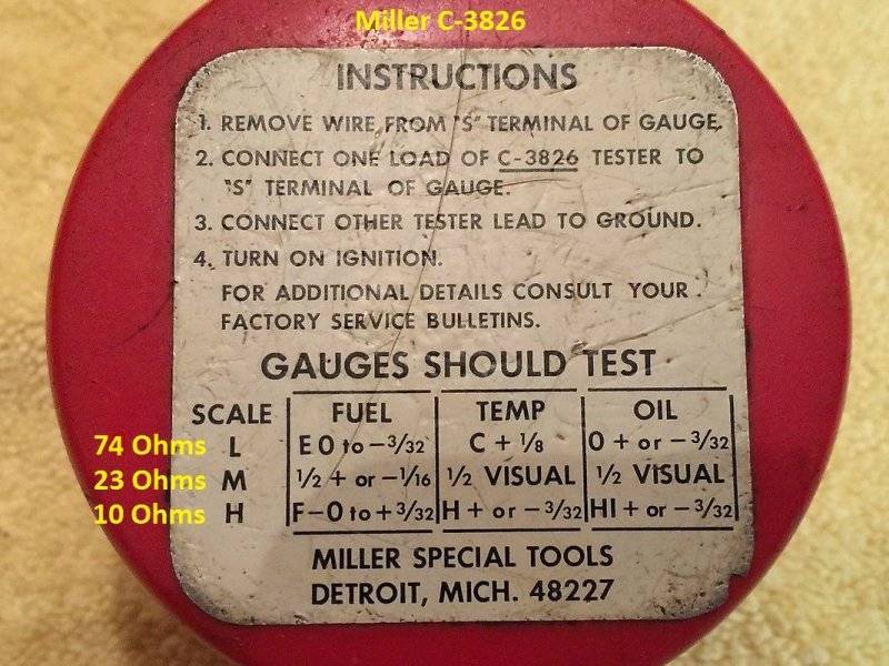

That's really cool to see the actual tool originally used to calibrate the gauges. I also note that each gauge is tuned slightly different on the plus/minus target. Definitely, great info.
To clarify on my question, I have already done the gauges, although not with that exact extra "+/- tune" information, they are pretty well set up.
My question lies with the sender units. As an example, it is noted the Temp sender is actually about 250ohms at ambient. Similarly, I am curious what the OEM Oil sender put out at no pressure and if it truly went all the way to 10ohms at 80 (the top mark on the gauge). Just because the gauge is set up for a full range doesn't really mean the sender has the same full range or like the temp sensor could actually be broader.
I still think the calibration tool label is really cool to see. Thanks so much for sharing.
