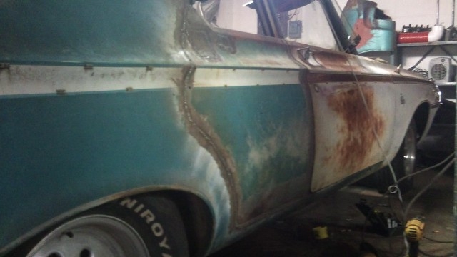

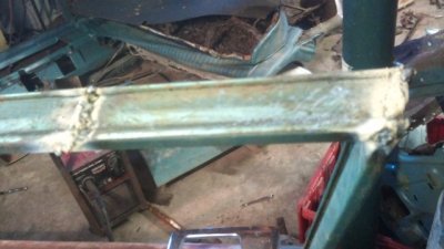

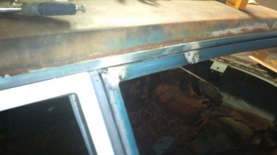

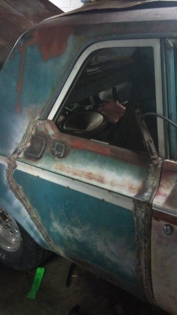

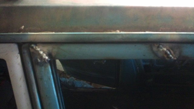

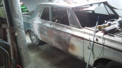

I didn't get any work done on the car this week but I bought some front turn signal lenses off ebay and bought the material to recover the seats. Then today I got the front widow channel welded and got the 1/4 skin tacked, welded, ground down, and glassed in. It looks like it's fairly straight, but we will see as soon as I start block sanding it.

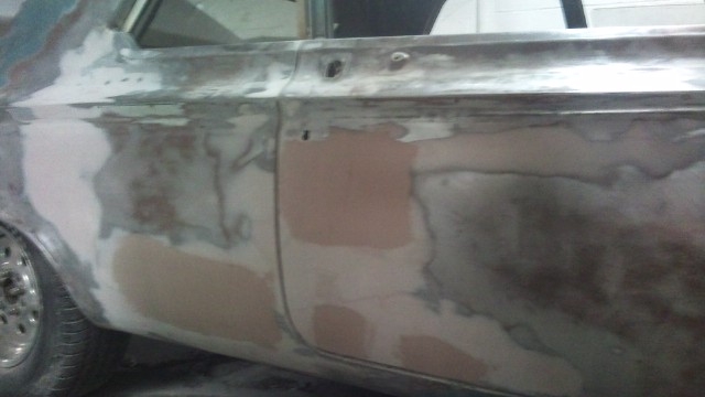

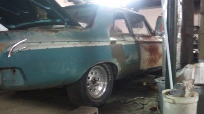

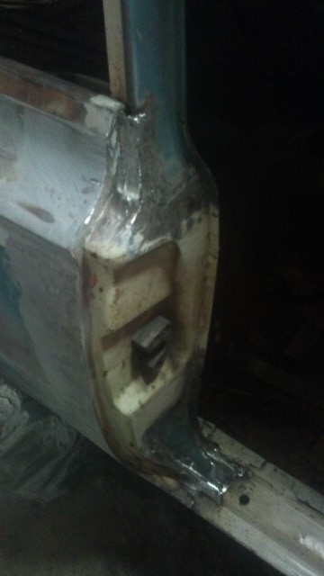

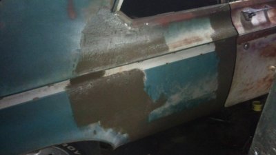

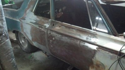

I got a little work done on it today. I got most of the welds ground down, and welded up the holes in the belt line of the door where the hdtp trim piece went. I got the fiberglass sanded down with 40 grit and there were some high spots that required some additional grinding. I sanded most of the door down as well, it had a bunch of dings and dents that I straightened out and a few pin hole rust spots I welded up. I've got a coat of filler on it and the blocking begins tomorrow. I hope to have it blocked down and in primer by the end of tomorrow.

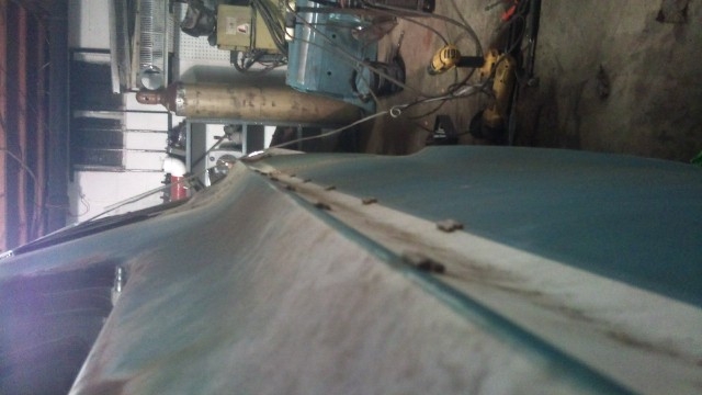

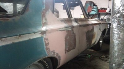

I hate block sanding!! I blocked it with 40, then blocked with 80, then blocked it with 180. There's only a few more low spots left, It should be ready for primer tomorrow. It's looking pretty good. I can't wait to see it in primer.

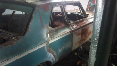

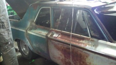

Time well spent if I do say so. and keep in mind 25 of those hours were spent cutting necessary pieces and stripping the too far gone 2 door hdtp. I'm not trying to make money on this car, it is my hobby. I do restore cars as a living but this is different, When I feel like working on the car, I do, and when I feel like stopping, I do, It's fun for me. And, the other side should take much less time now that I have things figured out, most time was spent thinking and measuring and fitting and thinking again and measuring again and fitting again, and so on. I started the money and time thing for my own records and for other people to see just what it takes. I have to keep track of time spent on cars at work and it's quite an eye opener how long stuff really takes when you do it the right way.
