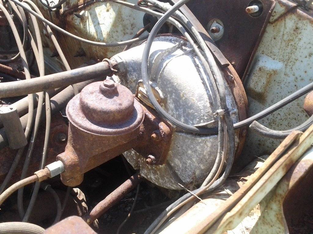

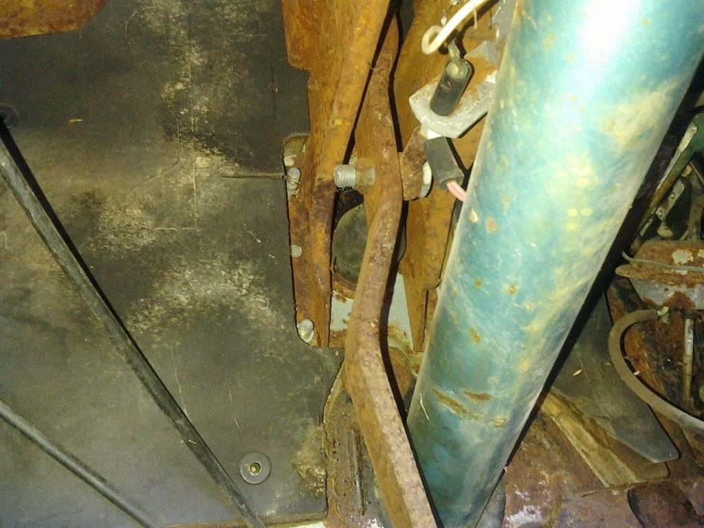

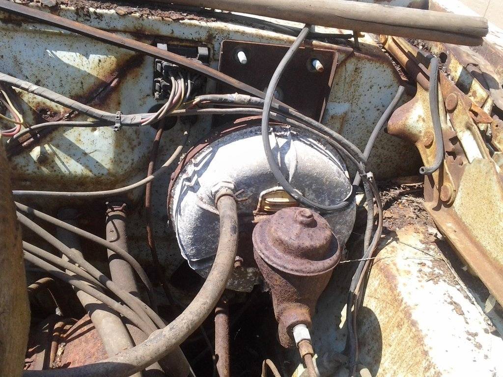

I have one I just got in a couple weeks ago on a 64 Polara...It looks to be original...Pedal is froze in place...Look familiar???
If you have the Midland 10 screw booster like the picture above Harmon brake parts will fix it for $200 I have the same Midland and sent it to them and it was back in two weeks
