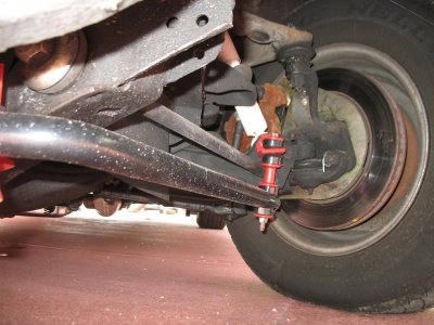

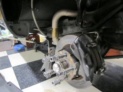

My 3900 lb brick is mostly street driven with 3 or 4 times to the track. I saw the stock parts conversion along with many other put together deals. I went with SSBC because they have a 4 piston caliper,and the kit was complete right down to the cotter pins.
