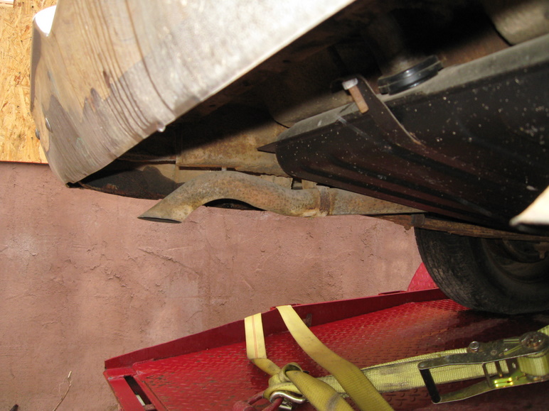

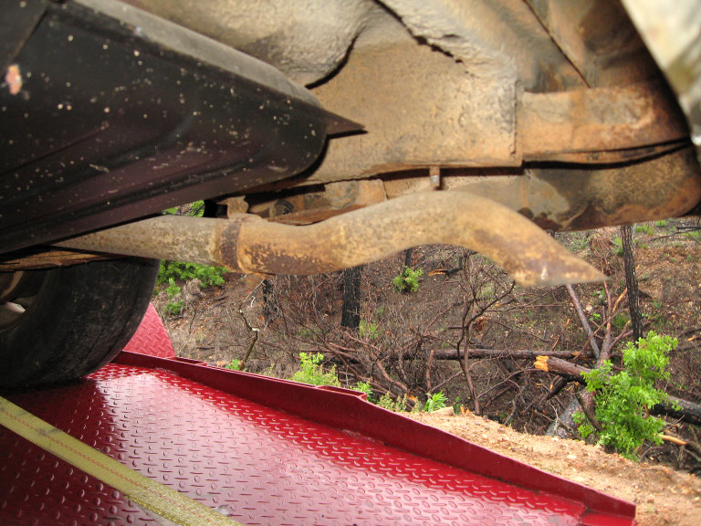

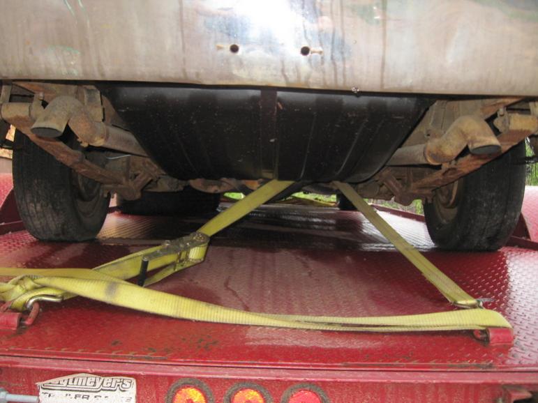

I'm Looking for A Picture I Can Give My Exhaust Guy Of Tailpipes For A 64 Dodge 330 Wedge Car. I Know They Go Up Slightly Before They Turn Down. But I Don't Know Where They End In Relation To The Bumper. Thanks For The Help.
Don't have a pic. but they run along the inside of the frame rail and gas tank! Yes they do have a slight bend up(a short j) The gap between the pipe and bottom edge of the bumper is apx. an 1"
I can only show you a pic of the pipes on my 63. These are TTI 3" pipes and they are hooked to the stock location hangers. I would think the 64 Dodge pipes exit about the same. Ron
Here's the exhaust on my '64 Polara (factory 383 4/speed car). Don't know if its original but suspect it is as I have all the records for this one and there are no receipts for a replacement exhaust system.

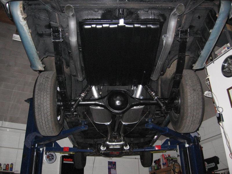

The stock location is cool and all......and I know that's how they came, but it just don't do it for me. I like them run between the frame rail and leaf spring, then between the quarter and leaf spring and angled sorta down and out about two thirds the way of the bottom of the quarter.
I like em better this way !!:laughing5:
That's not my style, but it will do the job.
