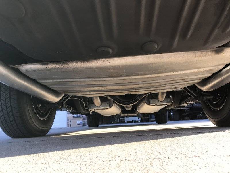

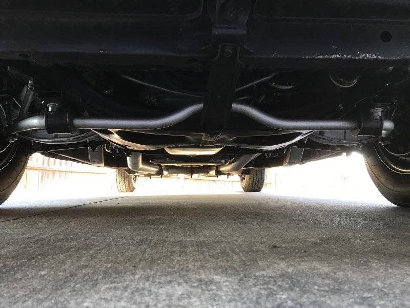

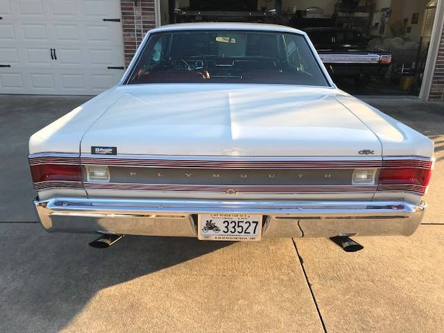

I have 2-1/2” TTI on my 67 GTX. The 2-1/2 tailpipes are a tight fit but it ends up fine. The bends are much better than any stock ones, the DynaMax muffler cases are not crimped on the corners, and as noted above the muffler hangers do not look stock, but overall it looks reasonably close to OE. Back when I installed it 25 years ago I could buy SS 2-1/2” muffler tips but I understand they are hard to find now.
